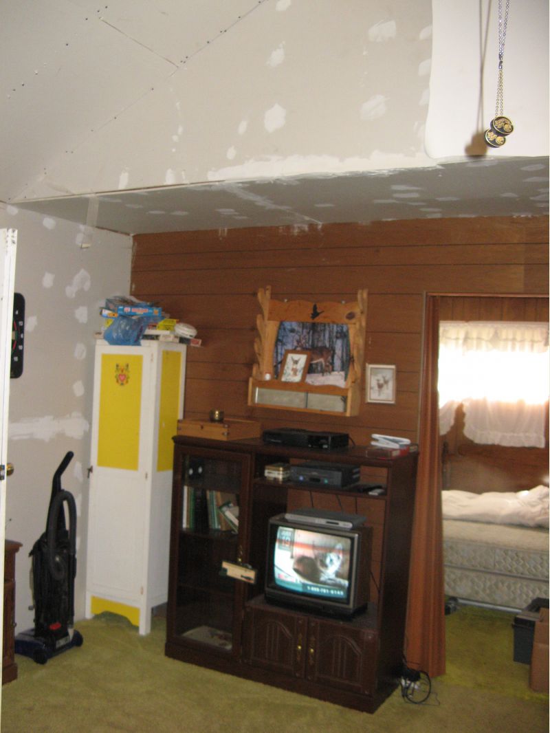

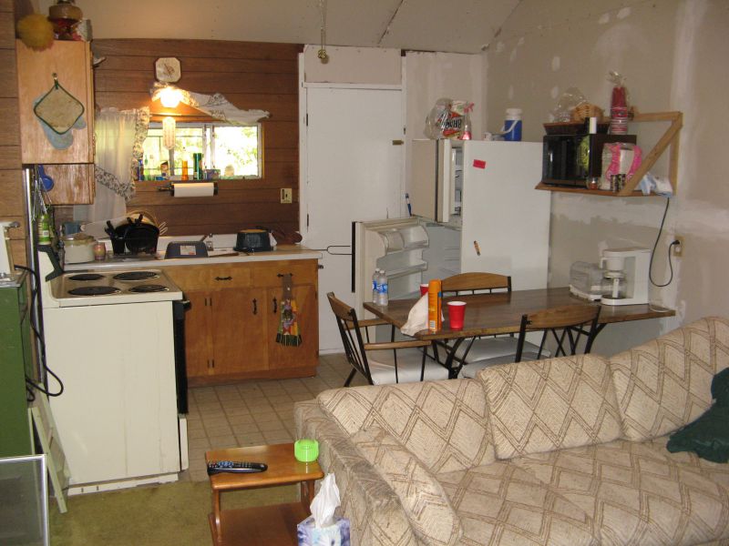

Before Pics

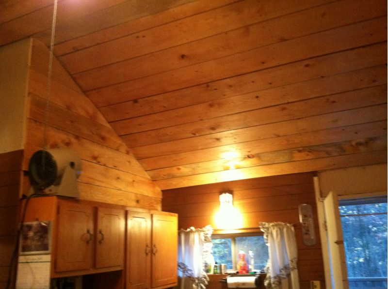

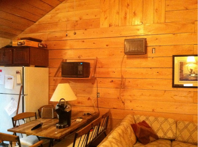

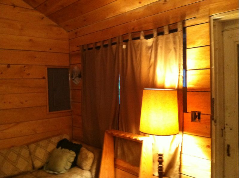

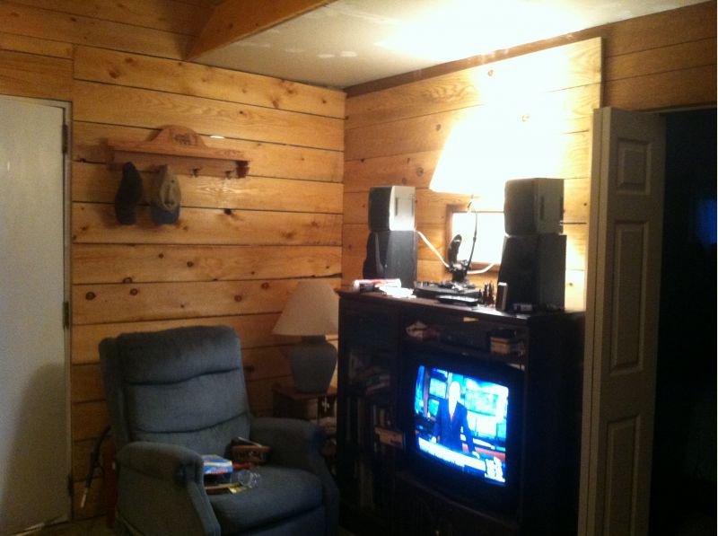

After Pics:
After Pics 1
After Pics 1
After Pics 2
After Pics 2
After Pics 3
After Pics 3
After Pics 4
After Pics 4
hct4all
# Posted: 16 Oct 2014 07:54pm
$400 in hemlock.
60 hours in labor (3 weekends 2 people)
$80 in poly.
Tons of fun.
Except for planning the lumber. That was not much fun.
If I had to do it again I would order 1/2" thick and pay to have it planned.
