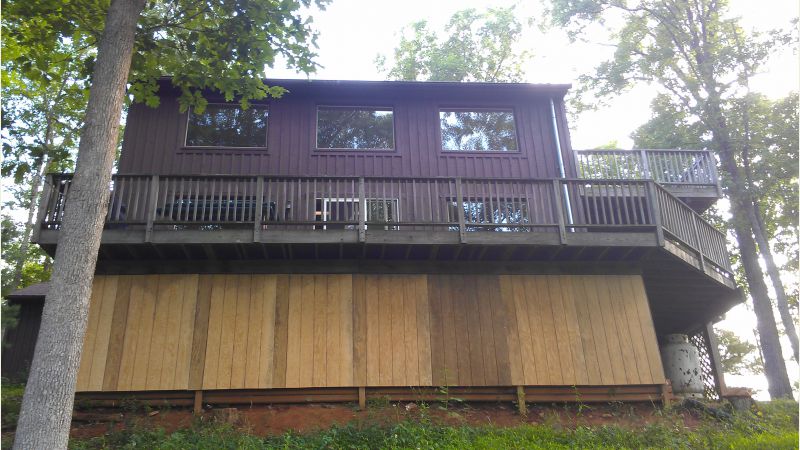

I've used T1-11 plywood to enclose under my cabin deck. Now I want to paint it to match the rest of the cabin exterior walls.
Here is the material I used: http://www.lowes.com/pd_12957-44903-NA_0__?productId=3010839&Ntt=
Any recommendations on the type of primer I should use?
My wife also wants me to put furring strips over-top of the plywood, so that it matches the top part of the cabin. Should I prime and paint the siding first, and then prime paint the strips before applying to the siding?
Thanks, Rich
# Posted: 18 Jul 2014 11:28am - Edited by: bldginsp
Different primers are meant for different tasks, what you want is a bare wood primer, not a primer meant for existing paint or metal or whatever. Talk to your local paint store. Since it is the primer that creates the adhesion, my belief is to get the best primer available and prep the surface as much as possible. Bare wood needs little if any prep.
Pretty much any top coat will adhere well to any primer, so I tend to skimp on the top coat after spending a lot on the primer. When I painted my used metal roofing on my A frame, I paid $50 for a gallon of super duper primer ('it'll stick to anything!'), and $10 for a bucket of color mismatch topcoat that they had in the back room.
As far as the strips go, painting the wood beneath first is extra insurance against rot. After you install the strips you'd be best off caulking the edges of them all, if that surface is going to get a lot of water against it. Water caught between two pieces of wood promotes rot, on plywood just like any other wood.
