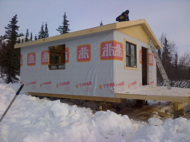

rhjv
# Posted: 8 Apr 2014 12:02pm
Here's a pic, notice the hight off the ground. Still got a lot of snow here.

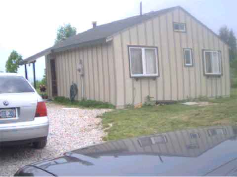

# Posted: 8 Apr 2014 12:17pm
I have built 2 with 3\8 plywood a 24 x24 cottage and a 8 x 13 Bunkie
just the way you say tyvek , plywood , sealed joints ,1 x 3 batons
now 15 years old kept them painted .
bunkie
bunkie
24 x 24 with loft
24 x 24 with loft
