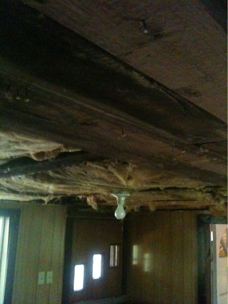

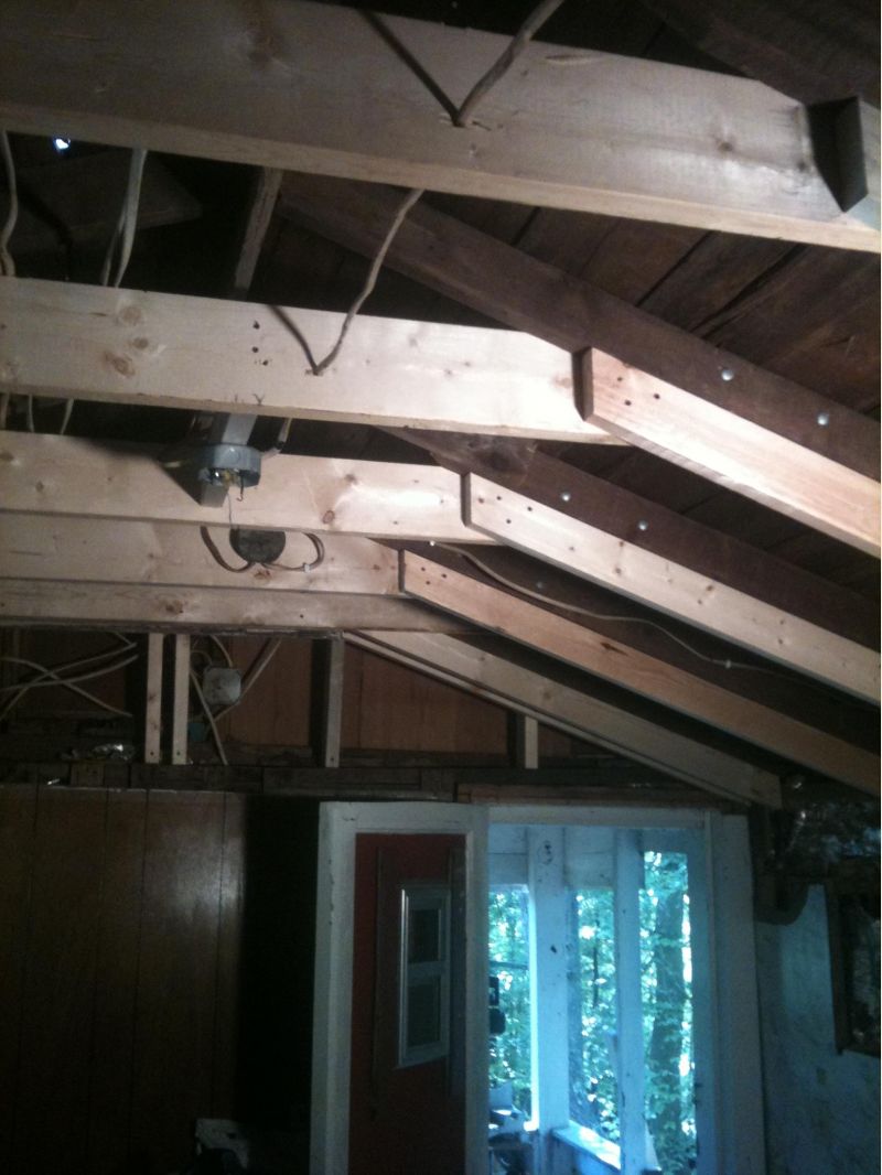

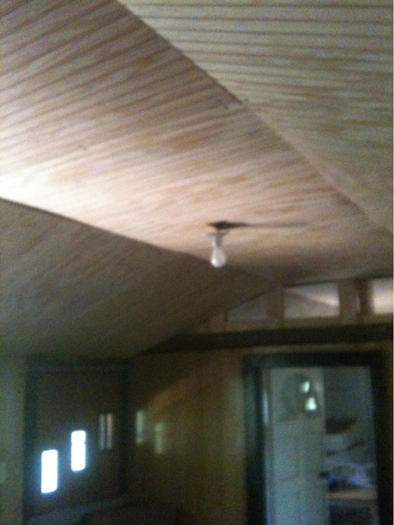

DLMcBeath
# Posted: 17 Dec 2010 05:46pm - Edited by: DLMcBeath
I think I solved my issues with my low ceiling. I thought I would show you all what I've done so far. Here are a couple before and after pics. I haven't done the trim work on the new ceiling yet.

I'm with him. Or maybe install your rafter ties in place before cutting out the ceiling joist.
OK, I see you got it. I would of extended those shorter ties (the angled part) all the way across the new ceiling joist (rafter tires now) and I always avoid drilling holes for wire into anything ceiling/roof. Just laying them on top of the rafter ties would of been fine too. I think that will be fine.
# Posted: 18 Dec 2010 03:59pm - Edited by: MtnDon

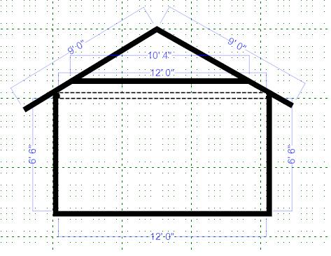

FWIW right now, if those ties that are bolted into place are not in the lower third of the rafter length they may not be doing the best job of preventing wall spread. Looking at picture 0323, that 2x you called a ridge beam appears to be only a ridge board.
A ridge beam would be supported at each end wall with 2x's or 4x's that would carry the beam load straight down to the foundation. A beam would also be larger in most buildings. You appear to have the more common ridge board and rafters. This means one half the roof load is carried down to each side wall. That load both pushes down on the wall and pushes out perpendicular to the wall at the upper wall plate. The rafter tie, the piece that prevents wall spread, should be in the lower one third of the triangular space formed by the rafters and the wall tops. A ceiling joist sitting on the wall top plate is in an ideal location to prevent wall spread. If it is above the 1/3 line it is difficult to restrain the outward forces. Especially if there is snow loading.
What you have appears to be more like halfway or even in the upper third.
FYI, just a further note, the upper dross ties are known as collar ties. Their function is to restrain the upper ends in situations of high winds. In places with tornadoes or just real high winds one of the ways roofs fail and are torn off is when a window or two are blown in. The wind then enters the building. The roof sheathing and rafters can then peel back as a unit. The collar ties try to prevent that.
I'd keep a close eye on the side walls, watch for any bowing out at the top.
