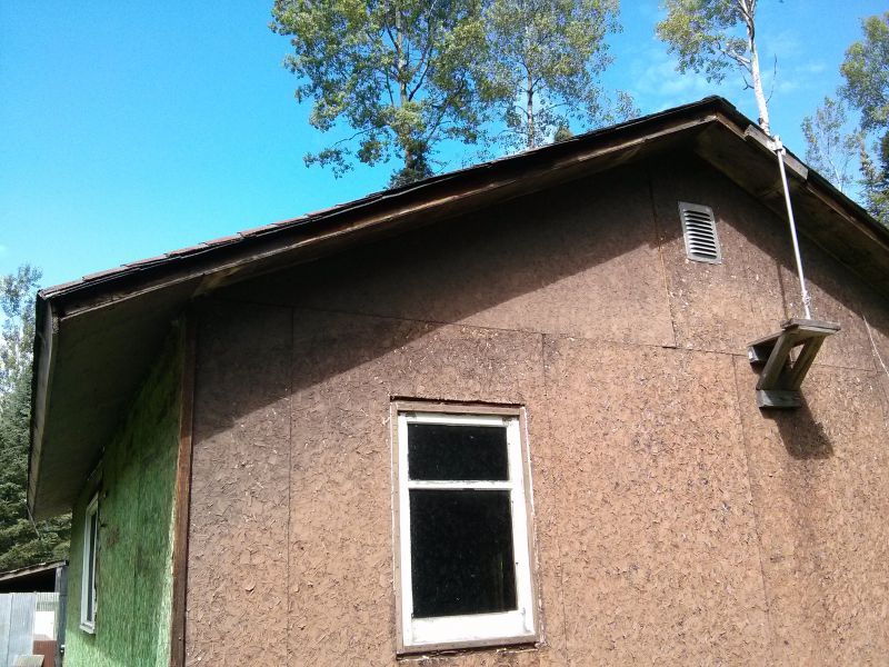

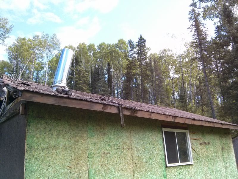

I need to patch the roof before winter. I've never done this before.
Simply put, do I repair the trusses, lay down new chipboard, tar paper, and shingle away? I'll pull out the pipe for now as well.
Then board up the windows etc.? If I board up the windows should I have a couple vents to keep the interior environment relative to the outside environment? Should be seeing up to minus 30F days at some points.
Over this winter I'll make a plan as to what to do with this cabin next spring.
Frame and electrical is pretty decent. Insulation and interior needs gutted. Cabin needs re-leveled or even moved as it's situated over a spring of some sort.

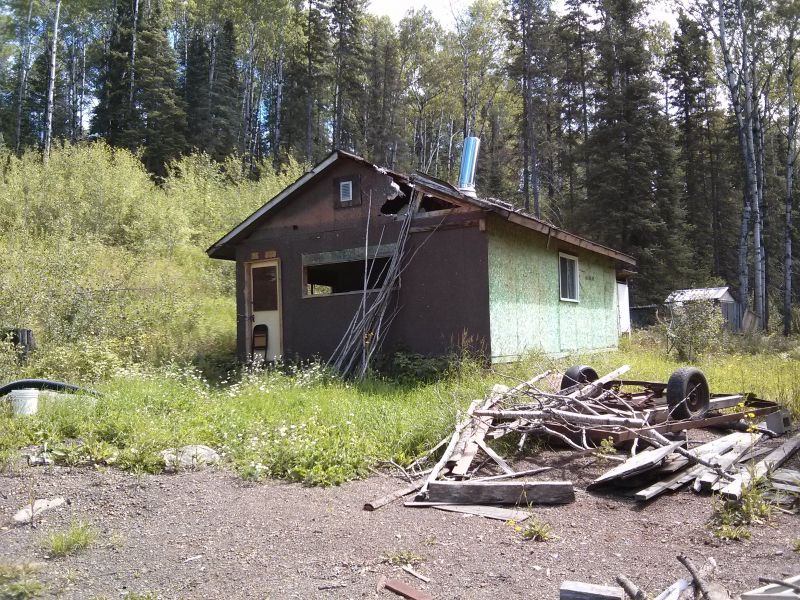

Some say tear it down, and others say keep it. The frame does seem solid, and there's extensive electrical connected to a 200 amp breaker box w/ ground plates.
I would rather the hassle than perhaps paying more if I started from scratch. It's a 27x20 cabin.

Have fun! I'd check that sheathing for mildew/mold, it may have to be replaced. Let us know if ya need any advice....
# Posted: 13 Aug 2013 09:59pm
as long as the footings are solid and level I would say fix what,s there that way there are no permit issues . looks like a 4\12 roof should be easy to fix. welcome aboard. lots of help here ,take lots of pics. good luck .

Now you got me thinking.... patch for the winter or redo the entire roof?
Rodents got in to the roof so I'm assuming that everything needs gutting. Could I redo the roof and gut the ceiling and insulation from the inside afterwards? Or is it ideal to re-roof after I've cleaned house down to the frame?

The previous owner was going to jack it and put two beams the length of the cabin under it, but he never got around to it. Another person claims that the floor is "soft." Having no experience, when I go inside it feels pretty hard to me. Needless to say I'm going to assume it needs to be leveled and fortified some. Possibly moved as there are signs of a spring coming up through the earth to one side. By spring I mean some wet spots

I'd say buy a couple air jacks or hydraulic ones, 8 ton or something and gently lift it up. If the floor joists are in good shape try doubling up a 2x10 and using it to span between or more joists and lap over the rim joist. Place the jack in the middle of your 2x10 so you're spreading the pressure out over all 3 or so joists and the edge of the 2x10s are catching the rim joist. this is assuming you have room to get that stuff under there of course. try lifting at two corners at once to prevent twisting and then do the other two corners. Work your way back and forth between the ends of the cabin and keep blocking it solidly and adding blocking under your jacks so you can get more height.
Try get the thing up 3 feet or something and then maybe you could form up some 2x6's into concrete forms like i did on mine. 3'x3' and put them under each corner and a couple in the middle of your long span. Pound stakes beside the forms and put screws in to level your forms, or you can use blocking but pegs are better. fill them with concrete mixed in a wheel barrow and screed the tops off level with a two by four. once the concrete is set Use a laser level to find a good height for the building to sit at and if each pad is at a different height you just figure out what length of post is needed at each pad so that the tops of all your posts are level with each other. Cut 6x6 treated posts for each height necessary at each pad.Since you wont be able to pour a pad under the middle of the cabin realistically you should run some hefty beams between your posts perpendicular to the length of the cabin, and notch the ends of the beams so that more beams can share the tops of the posts and span the posts parallel to the length of the cabin. If you dont have somewhere you can get long beams then glue and screw 3 2x8's together to make beams. Use PL400 or similar and lots of screws and make sure that each run of 2x8 laps the joints of the other runs by at least 6 feet or whatever works best for the length of your building. Just make sure it is REALLY well blocked before crawling under there to set a beam on your posts. Then get some strong metal straps and wrap them from one side of the post, up and over the beam and down the other side of the post with a lot of heavy joist hanger nails pounded in through the straps. Theres also the option of using big lags and bolting metal plates where the beams meet the posts. Do a bunch of braces between your posts, making sure they posts are all level and then you should be able to lower the building onto the beams. Try get the bracing to butt up against each other piece so that not only are nails holding it but it is transferring load from the beam down to the pads. ANd dont use screws except maybe to hold the bracing for nailing, as big spikes have much higher shear strength than normal deck screws. My pictures on the thread about google sketchup might help you a bit, but right now i dont have the blocks in the pictures that will transfer the brace strength to my pads. Once you have set the building back down tie the buildings floor to the beams with metal strapping or better yet some drilled metal plates with big ass lags crews let it sit for a couple weeks and then check your levels again. Use a transit or laser level for this as checking level on a warped floor doesnt tell you much. Get some metal or good cedar shims and go around shimming any that are low, up to the level of your highest point. Also remember to get some copper wood preservative and paint any of your cutoff edges on your treated posts and since concrete can eat away at your posts make sure you put something between your posts and the concrete such as rolled roofing or pieces of asphalt shingle. Paint any weather exposed wood on your foundation with the copper preservative too.
I'm not sure if this makes sense but feel free to ask lots of questions, it isnt an expensive fix for the foundation and i dont think its as difficult as it sounds. If you want i could do up some drawings when i have time.
As far as fixing the roof is concerned I'd first check that your wall studs and top and bottom plate of your walls are in good shape.
If they are then go through and replace any thing in the roof that needs replacing, and then put sheet metal roofing on. If its gonna be cold there then maybe consider a ridge vent and good metal soffit. And when you insulate the roof put cardboard insulation stops above your soffit to prevent the insulation from sliding down over the tops of your soffit vents. Gable vents would help too.

As for soffit you could make your own with 1x6's and metal screen but its a lot easier and quicker to use metal soffit. And I just realized that with the type of truss you have there the insulation stops arent really needed i dont think, unless im miss reading the picture.

One more thing, the main point of lifting it up is so air can get under there and dry things out, once it's dry you could put some skirting on with a few vents in it and maybe lay some plastic down to prevent moisture coming up from the dirt, and blammo, set for life. Or at least the life of the cabin ;)

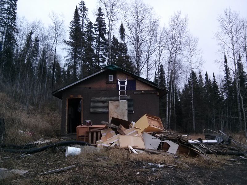

Well I managed to patch up the roof and seal things up. Also gutted all of the interior siding and insulation. I would of loved to have raised it if even temporarily for the winter, but I'm just a bit slow in this dept.

There appears to be three log beams running length wise under the joists. The log beam to the far left is 90% buried. I thought about freeing up these timbers completely off the joists and raising the cabin without them, but it's been suggested otherwise. Dig out around the timber and leave them on at least until it's off the ground.
I would like to turn the roof in to a split roof loft. With the left side sloped substantially higher than the right.
Could anyone suggest some options for getting help with plans for this? There will be windows and possibly a balcony involved

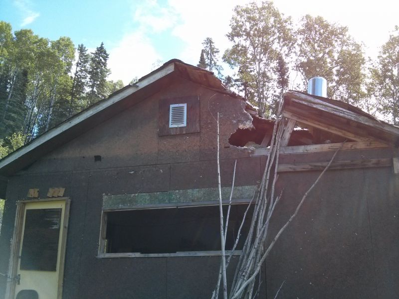

I believe it was erected about 25 years ago, and someone lived in it for about 15 years. Then for the previous owner it was a sort of hunt camp away from the wife camp. I believe he wasn't occupying it much as he was worried about the mold and rodents. He put the tree through the roof last spring.

I was up in the ceiling between the trusses in 42C (with humidex) heat, stomping out the ceiling. It was so hot I had to pay real good attention to my energy levels, and how far I had to move to get back down to the ground. It sure beat an overhead take down, and not having debris falling all over me.

If its been sitting on foundation logs for 20+ years and its worked, I'd think twice about raising it. If the logs, sill and joists are still solid, then I'd just leave it. As for the spring or seep, you might be able to channel it away from the house or dig it out and seal it off (although it will pop up again somewhere). If you are still going to raise it you could use concrete block piers, but shovel digging the footing for them would be a pain..but cheap.
Definitely strip the chipboard from the roof and go metal, either on decking or use nailer boards..again cheaper.
That's a heck of a project, but its do-able, stay positive!
