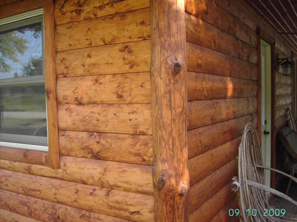

Anyone have half log siding on their cabin? How much maintainence is needed to keep it looking nice? Would you use it again?
Thanks
I like this look.

Owned and restored a log cabin. The lower half was siding the upper milled logs.
Lots of work to keep up. If the wood shrinks you end up with rain behind the siding. If you chink it and the chinking cracks even worse since the water has a hard time getting out. Nothing you can do about the wood shrinking seasonally...
Take a close look at the specs on chinking and you will discover that it is not easy to meet their spec (typically 3/8 on each side of chink joint) on how much log surface area is needed to make a proper joint. On 6 inch logs you end up with a 3/4 inch wide joint which looks pretty dumb IMO. You might pull it off with 8 inch logs and a favorable profile.
I had one "professional" log home contractor tell me to just chink it like you would caulk your bathtub (1/4" joint). I tried his method on a small section and it started cracking and pulling away in 2 years.

Seems like everyone I know says its to much upkeep. But what good is my dream cabin with vinyl siding.
Staining every 5 years doesn't seem to bad. Iwould use tongue and groove so no chinking.

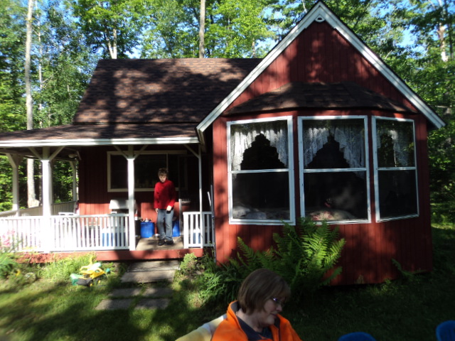

# Posted: 11 Apr 2013 06:53pm - Edited by: OwenChristensen
Well I've used it all on thousands of small buildings. T1-11 has vertical grain and sheds water better than any horizontal. grain lap siding. We've had very low warranty work and trust it for that reason. All seems are over framing, so it is very wind wash protected too. It also has great wind bracing strength. I'll admit that cedar lap siding looks great. Oh yeah, I've used it for thirty five years and I have a warranty that long. If I had to redo 1% of my work I would be busy and I'm not. Heck my own cabin is twenty five years old and only stained once.

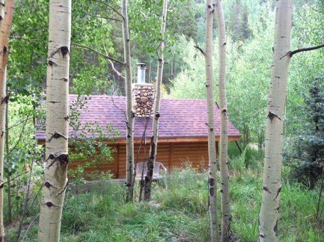

Our yurbin uses t&g log siding. I'd like to keep it looking natural so I finished it with a clear water based sealer it when it was first built about 2 years ago. I'll clearcoat it again this year -- only takes 4 or 5 hours -- I'm sure if I wanted to add color I'd get 5 or 6 years of protection ..
