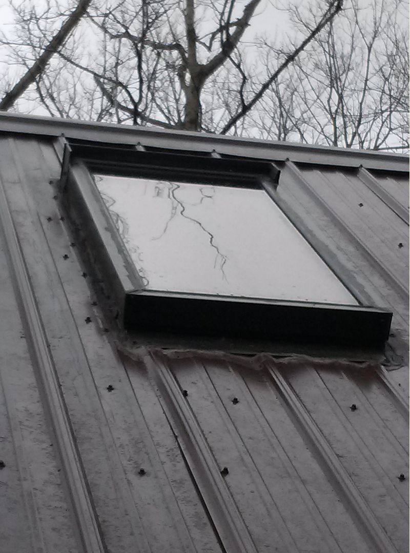

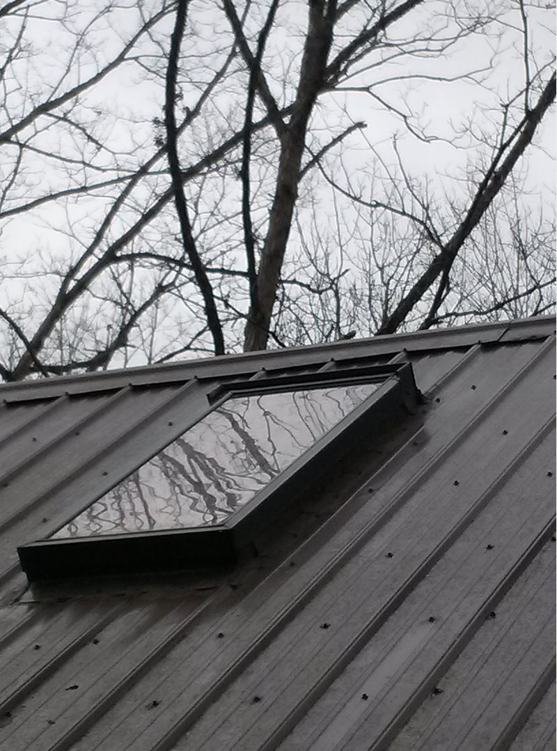

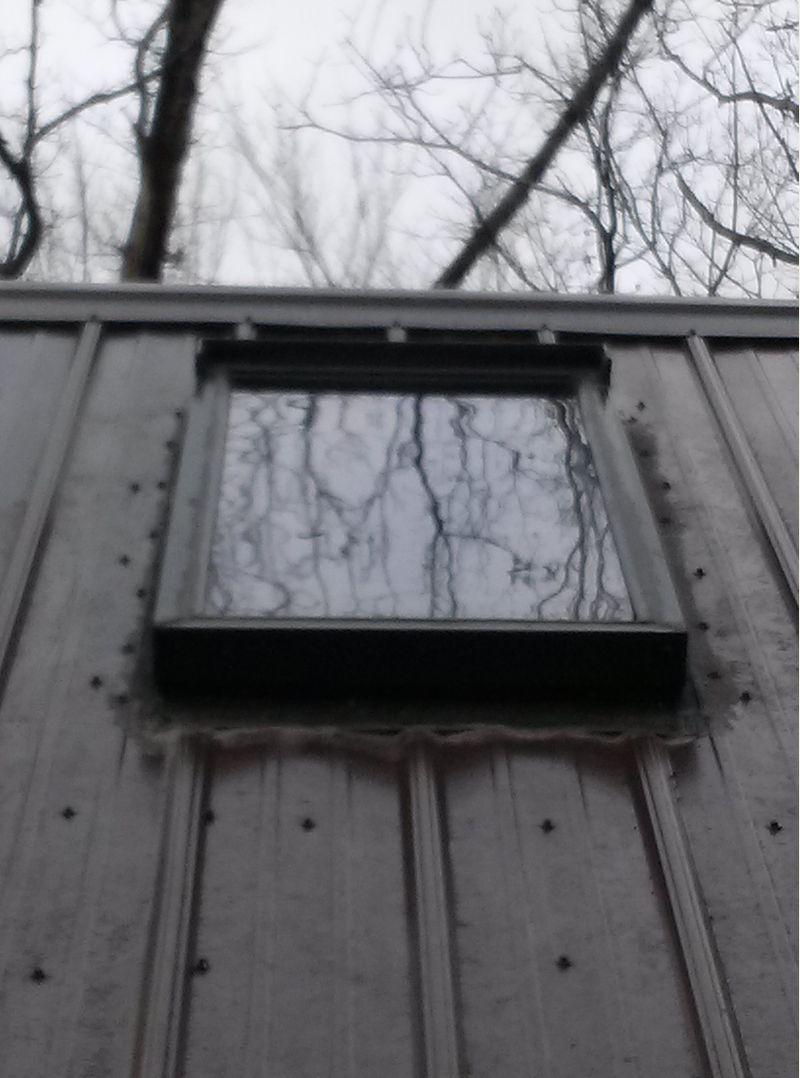

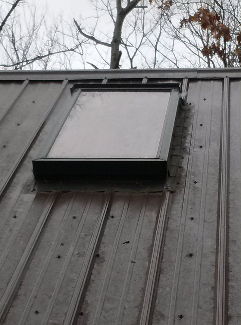

I too was shocked at the price of a flashing kit for metal roof. I used the standard flashing kit for 2 skylights 2'x4' and sealed the flashing with "Through the Roof" sealant and have had no leaks in 3 years. We had to flatten the ribs around the skylight and used roofing screws to tighten flashing and roofing but she's leak tight.

First let me preface that I am a novice builder that has to satsify nobody but myself. I made 4 roof penetrations, 2 for chimneys and 2 for skylights and these were the most stressful concerns of my entire cabin project. The skylights I bought new on Craigslist came with flashing kits for shingles. I shoped for sheet metal kits and was turned off by the price. We used what we had and then sealed all around with Through The Roof clear roof sealant which is the best stuff I've ever used. After 3 years of hard rains and wind, I still have no leaks. Not recommended by a professional builder but then, I'm not paying to have someone build my cabin.
