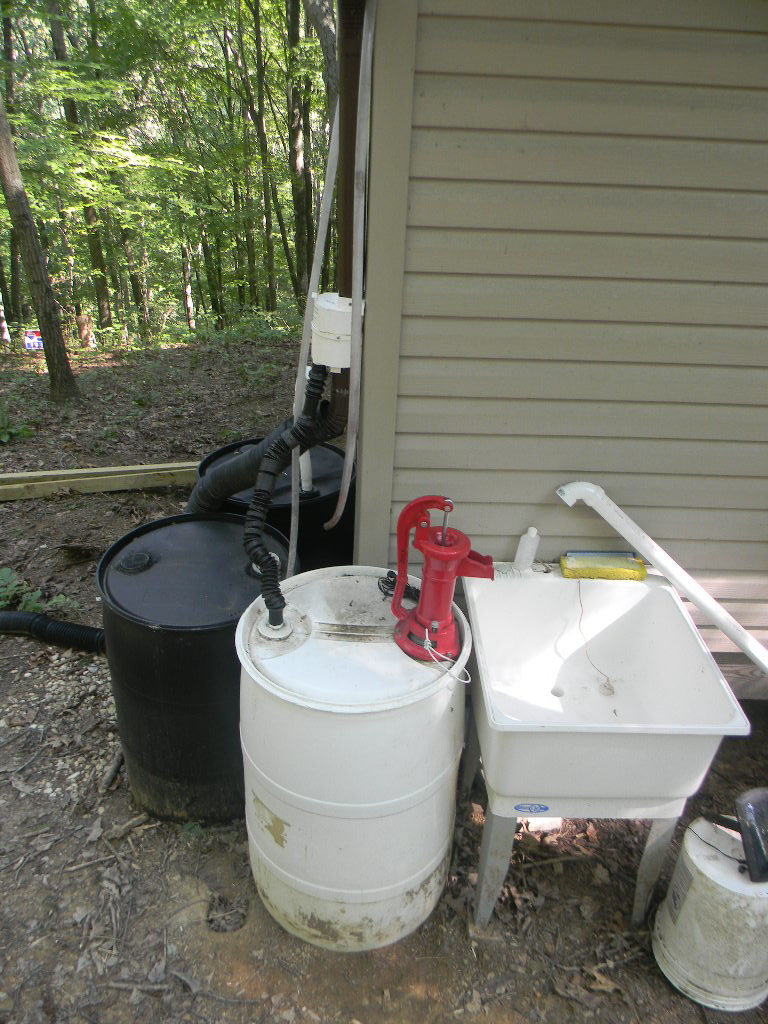

This sounds like a potential low-tech frost-proof setup- Lowes sells a pitcher pump for about $50, good for a shallow well (25 feet or less draw). It will lose its prime in a short time, so no frost damage and no draining needed for winter. Human powered and easy to maintain. I have one attached to a rain barrel next to an outdoor sink.
Outdoor sink and pump
