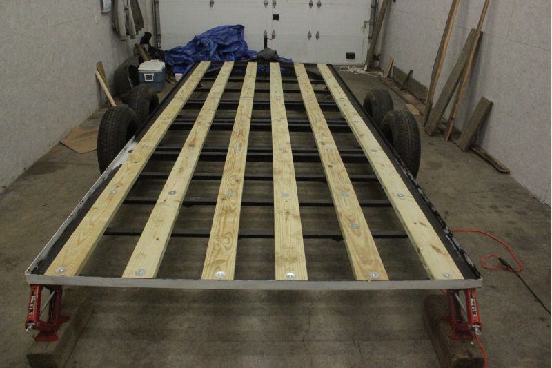

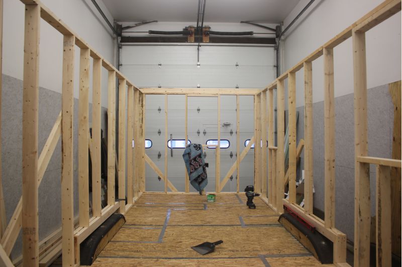

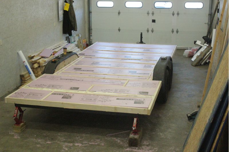

Pics - (The first is of the trailer pre-build, then the sub floors with the insulation in it. The last one is of the walls, what I just finished today. ) IMG_4508.JPG
