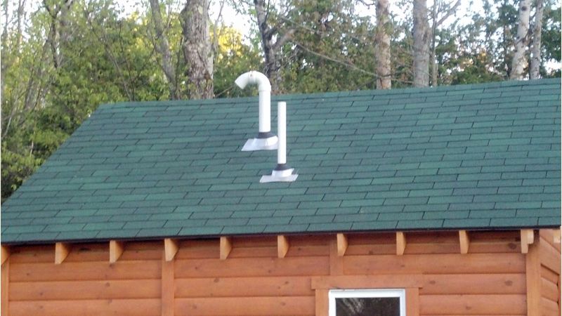

i looked at a on demand system and after trying to actually buy one from the local supply store i could not find one. i was told by the locals that "very few people use them in this area because the water is too hard and the manufacturers wont warranty them when they plug up". I'm using well water with a great deal of iron in it. on a brighter note, my hi efficiency propane water heater uses very little propane and i could not be happier.
