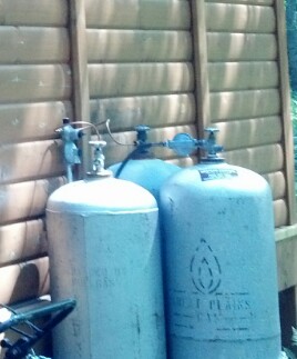

# Posted: 26 Nov 2012 10:56pm
i know you said you didnt want to get into a contract with a propane supllier but you will have to buy it somewhere. with that said one of these supliers can sell you the proper regulator you need. if you look the picture i posted, the two tanks against the cabin are piped to a common regulator. that regulator has a automatic switching valve that the lines enter. if one tank goes empty it will switch to the other tank. that regulator is attached to half inch black pipe that runs 50 ft. to my hot water tank. and the most important thing is to make SURE nothing leaks. fyi the suplier i went with gave those tanks to me i just bought the gas in them.
