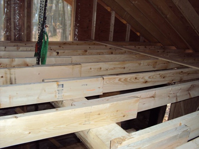

fpw
# Posted: 6 Aug 2012 10:21am - Edited by: fpw
Splicing works fine, but I would put some type of support under the splice.
These joists are thru bolted.
splicing
splicing

Great picture fpw. It always help for me to see something to make it stick.
