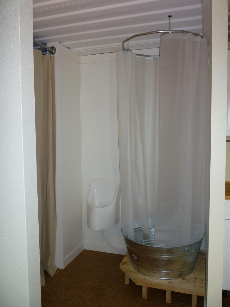

I made a shower with a 35 gallon and 31" diameter galvanized steel tub. The tub has a hole cut out for a drain that then feeds to a horizontal waterless trap from HepvO. The curtain rod is 1/2" galvanized conduit formed with a conduit bender and suspended from the ceiling. An advantage to this setup is that the tub can be used for washing other things such as clothes.

Steve961-
Talk to me about the urinal on the wall. Where did you get it, what's it called and how much did you pay please?
Thank you,
Dajtcha
Steve961
# Posted: 28 Aug 2012 06:22pm
Dajtcha:
It's a Waterless brand Santa Fe model waterless urinal. Waterless urinals use a cartridge trap with a layer of a mineral oil type substance that allows the urine to pass through. This model is made from a "High Performance Composite" resin and is fairly lightweight. but they also make some in vitreous china. The cost for mine was about $265. The best prices I had found on waterless urinals were at waterwisetech.net.

# Posted: 28 Aug 2012 06:49pm
Steve961 that is an awesome shower!
Spudmasher1
# Posted: 29 Aug 2012 04:29am
Steve961 that is what I call a small shower! Great job!

# Posted: 14 Dec 2012 03:53pm
Very clever on the shower! Nice.

# Posted: 16 Dec 2012 12:07am
Love that shower!!
