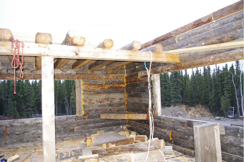

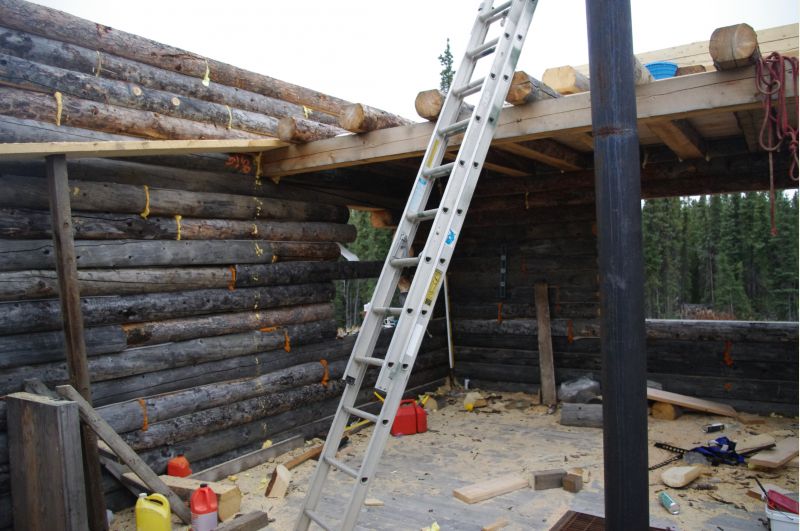

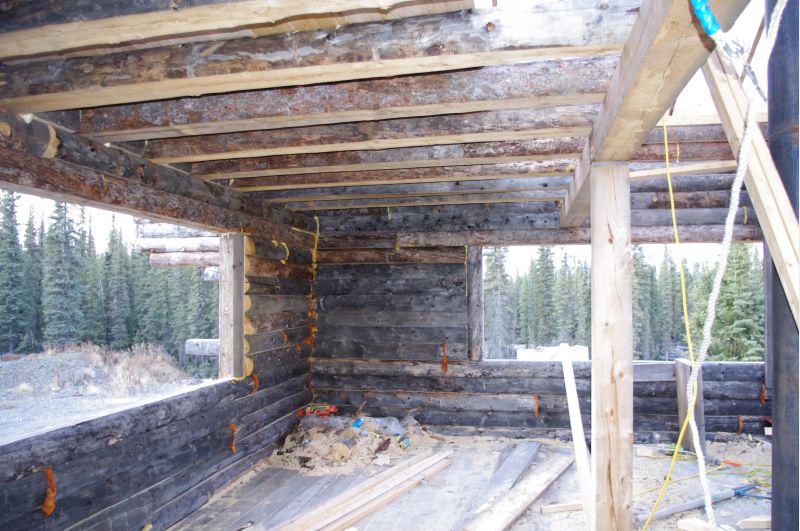

# Posted: 28 Dec 2011 03:59am
I used 7 inch rough sawn 2 sided logs for my whole cabin including rafters for the second floor and the loft floor. More strength than is nessesary but I like them. Here are some pics of my loft.
45north

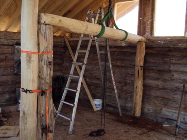

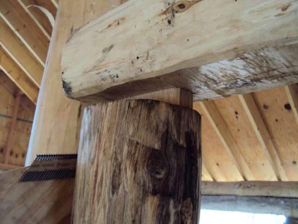

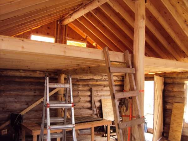

# Posted: 28 Dec 2011 04:05am
here are some more pics of my loft logs
fpw
# Posted: 28 Dec 2011 12:08pm
Split logs work fine. They don't need to be consistent. Just level up the logs on the flat side and and account for the distance with the post. I generally cut the mortise for the post at a set distance (say 6 or 8 inches) from the flat side, that way all the posts can be the same size.
