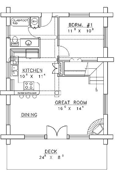

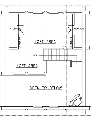

Ok guys I have found something close enough for what I want. It's going to be 18x24 with the 6ft deck to make it a 24x24 footprint. Just wondering what everyone thinks. Have a look at the pictures below!
For the layout this should work fine for me, but I will be adding a small wood stove. It will be located at the front, in the left corner. I'd like everyone's comments whether they be good or bad!

We started with a similar plan and ended up with a 22x26' footprint- 10' sidewalls and a 12/12 pitch roof. The original floor plan is below. As you can see, we planned on a main floor bedroom. Once the shell was built however, we decided to leave all the main floor open and put all the sleeping space in the loft. We have a 3/4 loft with a "bunk style" sleeping area in the back half of the cabin and a futon in the front section (open to below.)
I am not sure you'll be able to accomplish this floor plan with the footprint you have (it says the main floor is only 392 sf.) If you plan to have 2 bedrooms upstairs, you will likely need an entire second story, rather than a loft, as the pitch of the roof will make a LOT of that space unusable (ceiling too low.) We have 572 sf on the main floor and we would still have trouble getting 2 usable bedrooms there.
Hope this helps. Main floor- we opted not to do the walls and left it as a big great room
|  This shows only a half loft, but we made it 3/4 (only the 1/4 over the stove corner is open to above

Very nice cabin! The plan I posted above is a 22x19 plan, it's just a guideline for my 18x22 design. I think I should be ok with loft room. That plan is designed for a roof similar to my intentions, and the loft will be sleeping quarters only, so no need for extra space. The "open to below" area will not be open to below, that will be my storage area.

antler, your photo is a 1-1/2 story, not an A-frame - which is good, as it gives much more usable area upstairs.
i do notice there are no closets in your floor plan - except for the area under the stairs on the ground floor, which could be a coat closet or a pantry (or both).
of course you could use an armoire in each bedroom to hang clothes, and wall hooks or a clothes tree on the ground floor for coats, but it would probably be better to have more built-in storage.
for example upstairs if you swap the positions of the storage room and the smaller bedroom, i.e. put the small bedroom where "open to below" is shown, then the area in the very corner, where the stairway turns, there will be unused space for a closet - either full depth down to the floor, or at least 3/4 depth down to 2 feet above the floor, where clothes can be hung. that space would be above your head as you start to go up the stairs, and so is otherwise unused.
then that means your "lumber room" or storage room would be where the smaller bedroom is now, and a portion of it could be dedicated to a closet for the larger bedroom, i.e. the large bedroom closet would stick into a portion of the storage room.
antler
# Posted: 6 Jan 2012 09:41am
Reply Quote
That's a very good idea! There will be some coat racks and the closet under the stairs will store our outdoor suits. In my case we won't need anywhere to actually store our clothes, this cabin is just going to be a weekend get away for me and the wife and the cabin won't be heated while we're not there, so well be bringing our clothing back and forth with us. This is great input guys I love it!
