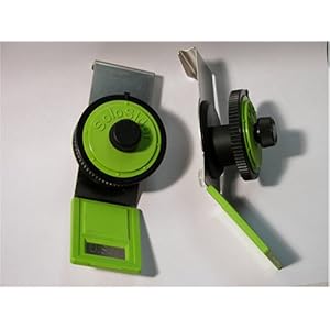

# Posted: 29 Sep 2011 08:00pm
Solosider makes hanging the planks easy even by yourself. I did our 16x30 cabin using these. They are adjustable for the amount of overlap desired.
