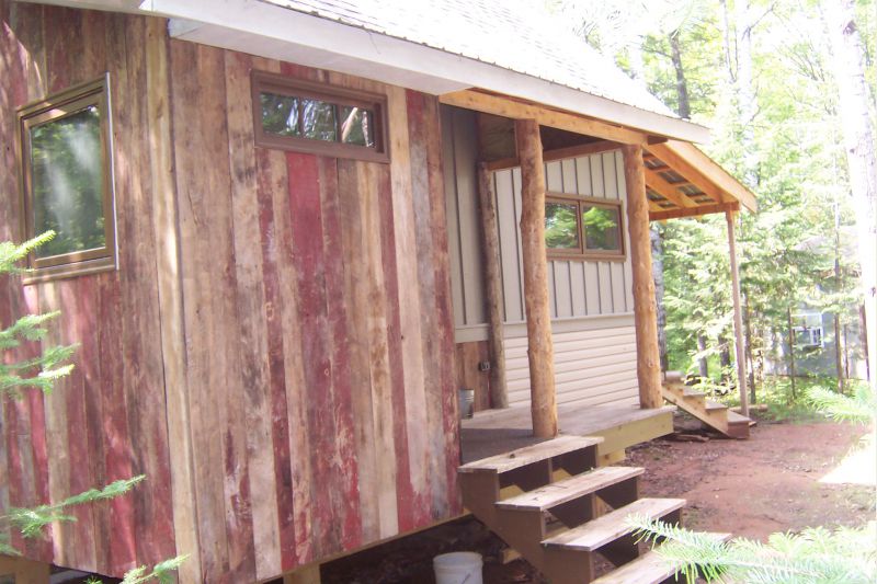

We salvage some old barn boards to use on our cabin for siding and would like to know the best way to seal them. We like the rustic look so we really don't want to paint them. Any suggestions?

We put up more barn boards outside this weekend and while I was thinking about everything you said about sealing them I wondered if where there is still paint left- I assume it doesn't absorb the new product, but the new product also will not affect the paint-am I right?

If you use a penetrating treatment, any existing paint could slow down the absorption or possibly cause the (latex) paint to bubble. Probably a good idea to do an inconspicuous test area first. I know you can definitely paint over CedarCide, but not sure on the others.
If you're going with a poly or varnish, or even repainting, you need to make sure that the new sealer will stick to the old paint. If you're completely painting it out, then it's advised to give a light sand, use a primer and then your new paint. But if you don't want to paint it, just seal it with a clear finish, you should test to see whether the remaining paint/stain is latex or oil. They say that you can paint one over the other as long as you sand it flat, but that has never given me good results... primers are nearly always required unless you sand down to bare wood.

Thanks! When we are ready to seal the outside boards we will have to test some areas. As you can see from the photo above there is still quite a bit of paint on the boards. We don't really want to repaint. Just don't want the existing paint to totally bubble up when a sealer is applied. Gotta give these boards a little longer life :)
