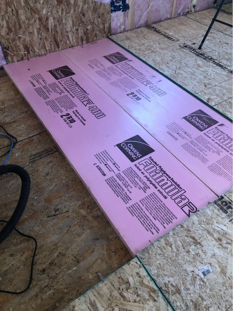

I sourced our insulation on Marketplace so I can't exactly remember the details. However, it was pink XPS certified under concrete. We used 2" plus 3/4 OSB as the second sub floor. Interior walls installed directly on top. Many basements are built that way up here to insulate over the concrete.
travellerw
# Posted: 26 Mar 2025 02:45pm
Here are a few pics.. Looks like it was pink Foamular 400 2" R10
