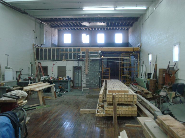

A pic from yesterday, we got the floor trusses up today. Look at the chimney on the left wall where I had to remove a section to let the truss pass thru. I'll remove the rest above later when we have a floor to stand on. Anyway, one of the guys was sure it would collapse when I took that section out of it. At most it would have dropped away to about a 45 degree angle. As luck would have it I hit right on the inner liner joints so the flue liner is helping hold it all together as well. (the bath vents and 2 furnaces on different floors used that flue... so wrong!)
