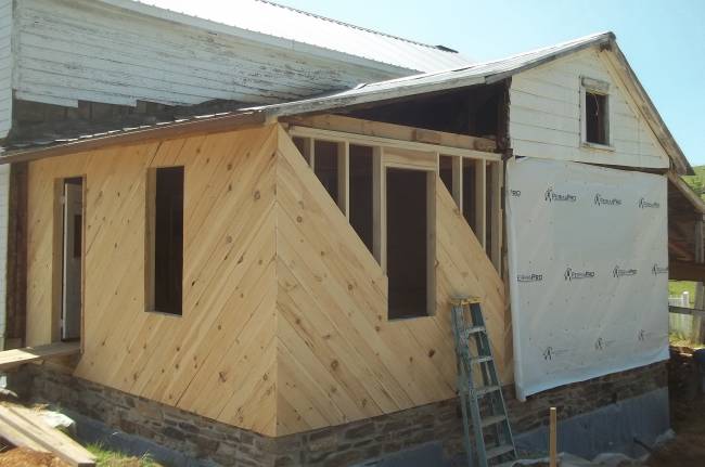

For those old enough to remember Julie, Link and Peter.. the Mod Squad. In the 70's during the oil crisis there was a push in the trade magazines called "Mod 24" complete with similar models in the ads. I checked the card in the back of Professional Builder for more info and showed it to my Dad. "We won't be doing that!". Ten years later I was on a production crew and yup, 24" framing with 1/2" drywall inside and celotex with vinyl exteriors. You could see the waves in the walls when you turned onto the street.
Yes 24oc is "prescriptive" and within code. There is nothing structurally wrong with it. Generally the folks doing it tend to be "value engineering" which is a polite way of saying penny wise and pound foolish. The complaints revolve around the bottom dwellers. The finishes may be rated for a 2' span but the deflections around the minimums can be annoying. I've never been in a shed that approached code minimums.
And we haven't even touched framing on 19.2" centers .
Dad's roof systems had a large "rafter" every 8-12 feet. Hmm, how in the world? We used 3ply glued up plank T&G decking to sheath it. Someone in another thread mentioned framing on 4' centers. Go back far enough and you'll find that was common Dutch light timber framing. I've worked on timberframes with supports in the 8-12' range. Wattle and daub was inserted/applied to earthfast posts spaced ~3' on center at Jamestown.
In other words there are many ways but the parts need to work together. During covid I had to do a little of my own value engineering. I sawed my own board sheathing for a project and applied the boards to the wall framing diagonally to brace the framing and sheath it with something stronger and cheaper than the osb prices in the worst of it. For someone working solo, this was light work after the walls were tipped up, just plenty of it.

Nice diagonal sheathing boards, DRP. Almost a shame to cover it up. I don't think I've seen any new stuff like that ever.
