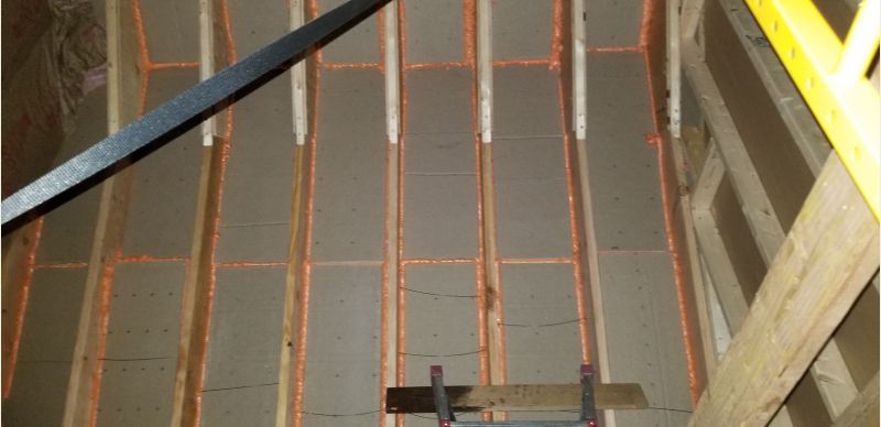

Useing foam board and sealing up the edges with caned foam will give you just about the same product as spray foam. It will take longer but it also dosnt have to be done all at once. You can also put up foam board when it to cold to use canned foam.
If you do this I suggest getting the pro gun. Way easier to control and you can close the gun/can for 30days and come back to a working can.
I did my floor and 4in foam along with my whole 20x24 gambrel roof. I'm about 32 large foam cans into this and about 60 4'x4'x4" sheets of poly iso. I would do it again how ever I would change the way some framing meets so it's easier to do.

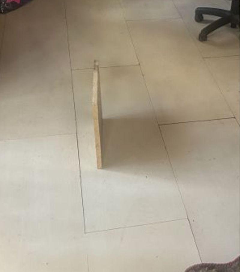

Cal89, Hmm, interesting. I might have the option of using that XPS stuff on TOP of my plywood, which is now covered with some inch thick particle board shelving squares. Might even be room to put those back on top, or some other thinner flooring.
Not that big a deal for me, only a couple freezing days here a year, plenty of firewood!
