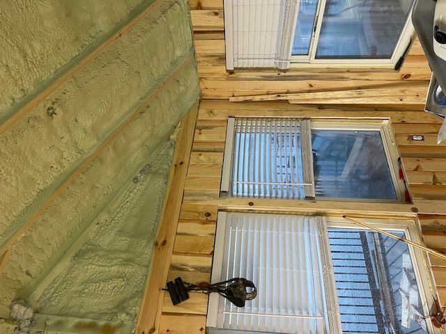

I had my ceiling and walls sprayed with closed cell foam. It is warm as heck now nut the noise from things like rain hitting my roof just comes right through. I knew that was a downfall of closed cell foam when I did it.
I have 2x6 rafters and plan on putting white washed pine boards on the ceiling. Is there any fabric or matting I could put down across the rafters before the pine to deaden the sound. I see stuff for vehicles called dynomat (which is way too expensive) but figured there are other variations of it. Think that would work?
I am not gonna try to mess with adding an inch or two of mineral wool sound deadening insulation, there is too much variation in the spray foam depth.
Pic shows corner with foam and walls.
Thoughts?

Here's the corner. Walls are done.
Corner
Corner

I am not aware of any sound deadener you could apply across the rafters that would suitable for securing boards similar to the wall siding.
The only thing that comes to mind is to first fasten 2x furring strips to the bottom edge of the rafters. Then install mineral wool batts and finally the 1x boards.
Johns Mansville sells a commercial rock wool product in a variety of thicknesses from 1" and up. I have no idea on costs for small lots. But maybe worth looking into.

I used 4in foam with r21 over that and cant hear a damn thing from the roof.
I think you have moved the reverberation parts inside the house so there not much you can do at this point.

I just wonder how much "deadening" I'll get from the 1x6 carsiding. Not sure I want to mess with any fiber type insulation.

I doubt you would get much deadening from car siding. Some? Yes. But probably not as much as you want.

Im sure there is 'sound (somewhat) deadening' sheet goods that you could put up over the insulation, then put on your finish ceiling. That may help.....but really, how many hours you are there does it rain that hard to bother you?
That's a good idea. Like 1in foam board over the rafters then the interior finishing.
