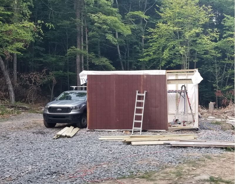

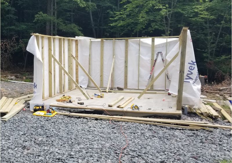

# Posted: 29 Aug 2022 11:28pm
My cabin is 2x6 wrapped in Tyvek then T1-11 walls
# Posted: 30 Aug 2022 08:04am - Edited by: toyota_mdt_tech
Yep, it does do both. I wrapped my studs in Tyvek and sheated it with real wood T1-11.
