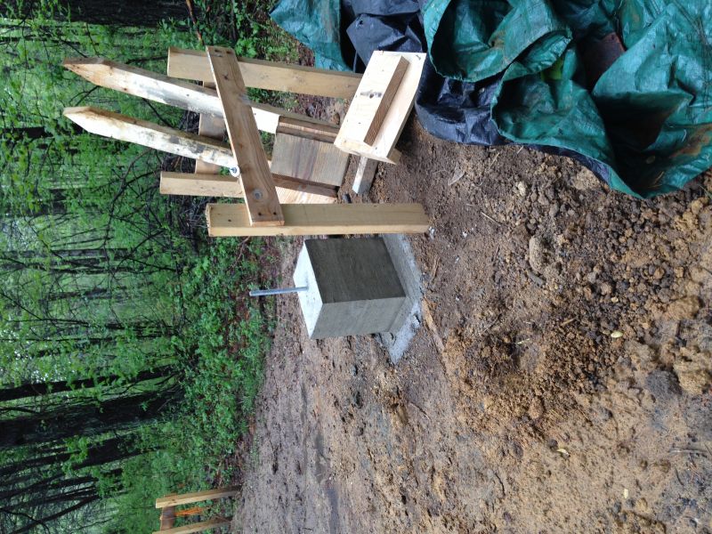

Tim_Ohio
# Posted: 23 May 2022 11:56am - Edited by: Tim_Ohio
Quoting: cabinnewbie
But seems like everyone does concrete piers only to ground level and then does a post and beam on top. I'm guessing it's because the strength of the pier is compromised above ground?
I'm not sure why you think this. Plenty of people do piers above grade that go below grade to below the frost line. I personally ran the rebar (4 lengths tied together in a square profile) about 2" below the top of the concrete.
pier
pier
