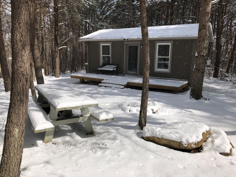

Carpenter ants are the biggest concern, but what is most important is the ventilation. No house or cabin is impermeable to insects. Keeping rodents out is the major issue. Most cabins don't even have anything covering the underside of the floor joists. As long as you are in the wilderness, you will have insects. It's as good as it gets. Repellents help to keep them at bay.
For instance, I threw moth balls under the cabin to keep animals from wanting to burrow, such as ground hogs. The odor repels them. A kind of skirt helps to. I haven't gotten to that yet. Here is what I built.

Oh that looks nice. Also, when calculating weight I forgot about the fact that the south wall will be half windows. Recalculated green weight of walls should be 9 something, but as I will be putting the logs up as I go, many of them will have had plenty of wind and sun and should be significantly lighter by the time we start getting snow.
