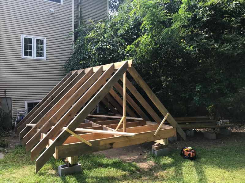

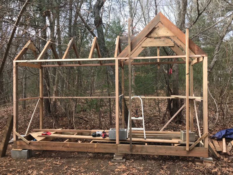

My two cents as this is exactly what I did do... I pre-cut my entire structure (sections at a time) and I was dried in in three long weekends (mostly by myself). You can see my floor joist and roof rafters assembled in my backyard at home before I disassembled and transported 200 miles north of my home here https://www.small-cabin.com/forum/6_9681_0.html
When it came to the walls I marked out all studs, jacks etc on my plates, pre-cut same to match layout, pre-cut window/door headers, jacks, cripples etc and bundled into "pre-cut-kits"...

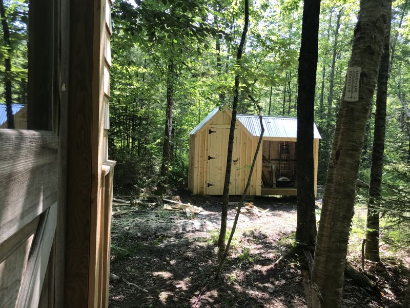

I also built my power/woodshed in the same manner.
Pre-fit at home
Pre-fit at home
Powershed in my backyard
Powershed complete in VT

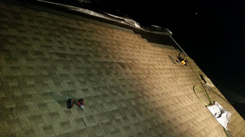

As to the roof in the winter. The best (and only good time) I have had doing roofing was when I had to shovel the snow off the tarp covering the tar paper. It was nice and cold. I have done far to many roofs in 95* heat when there no shade and you had to get off the roof by 10am.
At night in the dark of the winter is by far my favorite time to roof. No bugs, no heat, work as fast as you want and no sweat.
