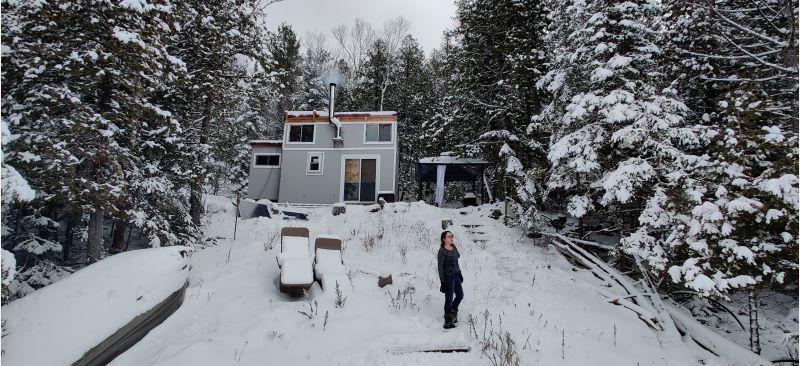

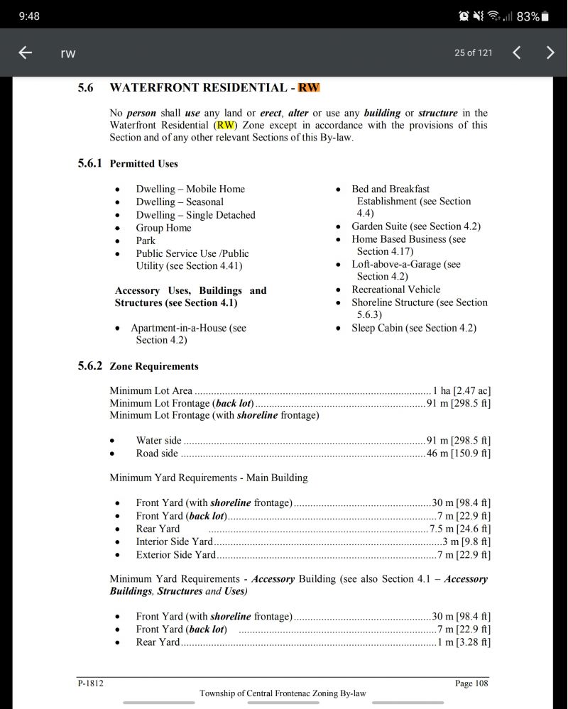

Ya we have no shower, no sinks etc. Straight camping. We have a commercial composting already with evaporation chamber. We're zoned RW which according to the bylaws means we can have a sleeping bunkie, or seasonal dwelling. This will a 100% off grid sleeping cabin, not even sure the composting will be inside it or in an outhouse. I've attached the tiny house rules for central Frontenac the building inspector provided. Also our current setup which we need to take down because it was built too close to the water and I'm fairly certain over the neighbors line ( by a previous owner, decades ago). We fought with insurance and received a payout to remove it, that in turn is the budget to reproduce it legally up the ridge
