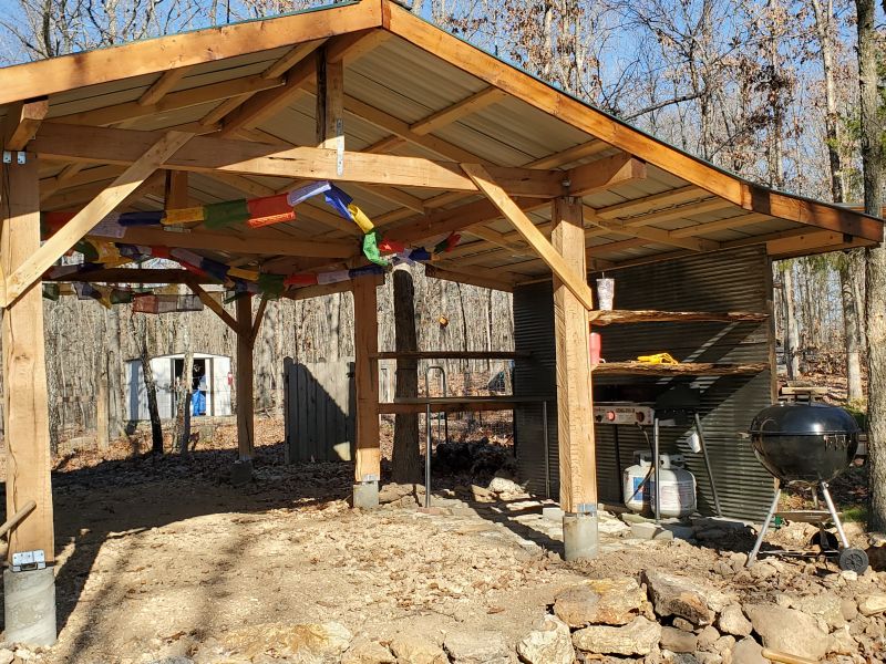

I used an Alaskan Sawmill to mill 6x6, 4x12 out of white oak. I used them on our 16 x 20 pavilion.
Had I had the sawmill earlier, I would have milled the beams for the cabin build.
