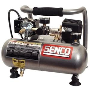

If you have power, you can get a Senco PC1010 compressor for about $100 if you shop around. I use this to blow out my entire system every time I leave our cabin.
