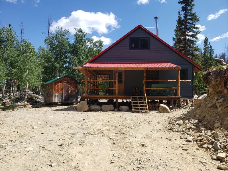

snobdds
# Posted: 4 Feb 2021 12:29pm - Edited by: snobdds
Quoting: Nate R
I'll look around, but do you have a thread on here for your cabin that I could check out?
I was not very good about updating it. here is a finished product.

snobdds that thing looks amazing!! Wish I could build something bigger like you've got there. The geothermal well is so rad too, great use of the natural resources to make your place more comfortable.
If you're ever in the PNW and want someone to show you the goods, give me a shout. I've been riding at Stevens Pass since I was 4 years old so I've got the place pretty well mapped out.

I just built it. I didn't ask for permission or what codes needed to be followed. THe old, it's easier to ask for forgiveness than permission. I did have to have the place rezoned so I could pay more in taxes, but they don't do code stuff here.
