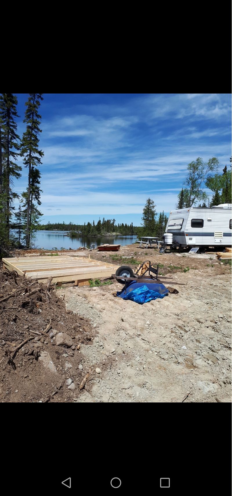

# Posted: 2 May 2020 10:40pm
Lot with trailer

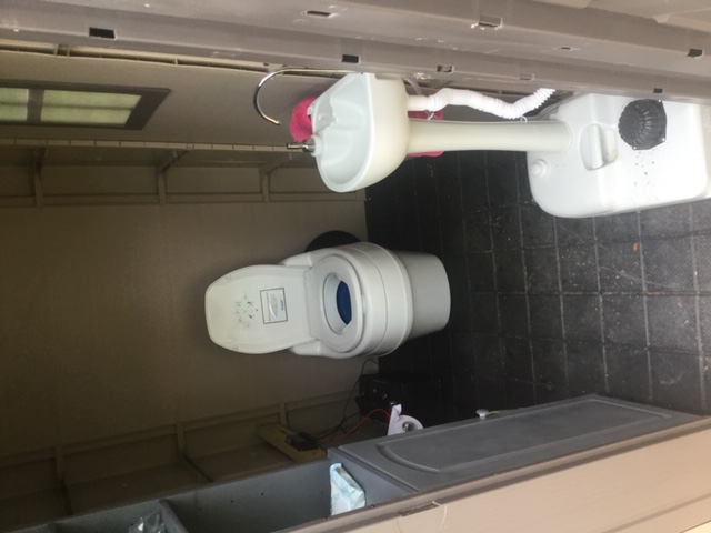

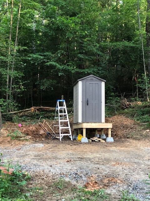

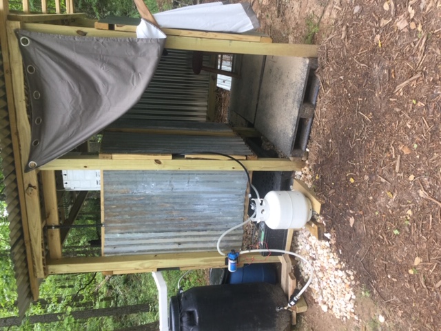

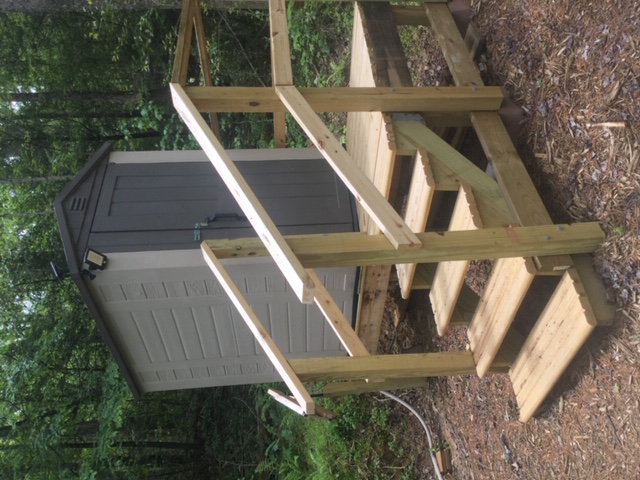

We built a stand alone composting outhouse at our cabin. We use a Separett toilet ( https://www.amazon.com/Separett-Villa-9200-AC/dp/B01N8QFWWV/ref=sr_1_1?crid=38DD8VP8U Q6E&dchild=1&keywords=separett+toilet&qid=1588766198&sprefix=separe%2Cindustrial%2C18 8&sr=8-1) and a 12 volt battery with small solar panel. For the building we used a plastic 4x6 storage building. It has enough room for toilet, hand washing station ( like this but without the toilet part https://www.amazon.com/VINGLI-Upgraded-Self-contained-Detachable-Lightweight/dp/B07G4 5QGMJ/ref=sr_1_1?dchild=1&keywords=Self-contained+5+Gal+Hand+Washing+Station&qid=1588 766605&sr=8-1)and a storage shelf in it.
It works great for us (2 adult men and 3 adult females) for a long weekend without having to empty. But emptying is just taking bag out and putting it in compost tumbler.
I will try to get some photos when I am up there next. Here is one when building it.
As for power on a trailer: I love lithium battery we have in our cabin, but not sure if on-board charger in a camper is set up to charge them correctly so I think you might be stuck with normal batteries. I used our camper to stay in as I was building cabin. I had a small (50w) solar panel that was hooked up during the week that would cover topping off batteries but I would run the genny when there for a/c or microwave and full charge batteries before I left.
