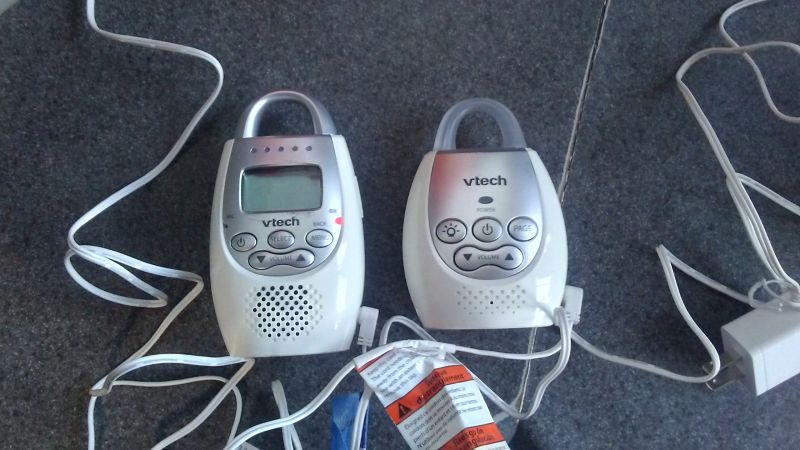

# Posted: 10 Feb 2020 02:29pm
Update: Scored this baby monitor from a neighbor. It's very basic, no video but it has two way audio and may work out. Been testing at my house in the ghetto. With the baby unit in the house I can hear what's going on via the parent unit, which I have walked 3-4 houses down the street with and is still linked up, supposed to go 100 meters in the clear. My wife can just start talking, I have to press the mic button to talk back. Nice part is it's about the size of a cell phone, easy to carry in my pocket. Rechargeable battery too. The baby unit takes external 6vdc, easy enough in the cabin.
Out to the property tomorrow for further testing.

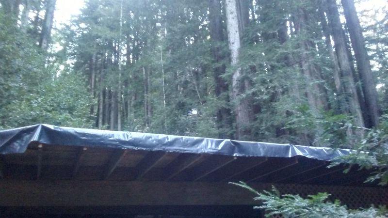

So tried the baby monitor today, works great! Here's a pic from my not yet finished carport/shop and the cabin window up above. I can hear my wife endlessly harassing the dog in the cabin, and she can hear me perfectly when I hit the mic button. My unit fits in my shirt pocket and weighs nothing so it's always with me when stumbling around the yard. No real need for cameras and screens, looks like we're set.
Thanks for all the ideas guys!
