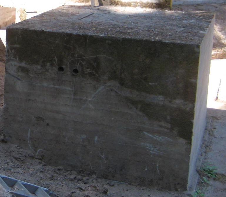

I have a concrete bunker on my property, 14x14. It has a narrow 24" door that I would like to widen. 6" thick concrete.
Think with a 7" concrete blade on a Skill saw I could make vertical cuts on both sides of the wall (same side of the doorway)? Or will it bog down or overheat?

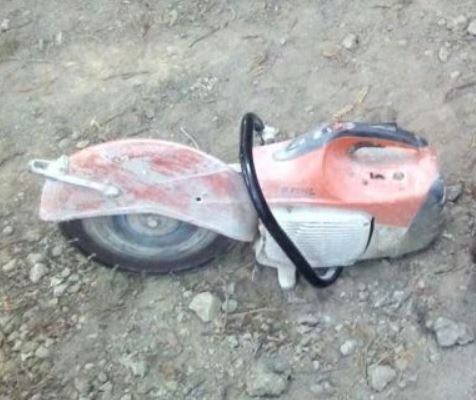

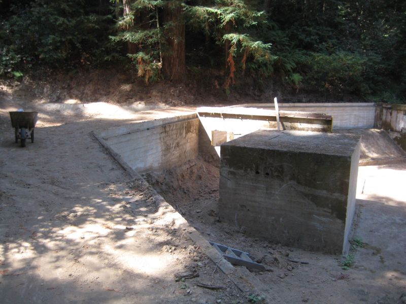

Thanks guys. I do have this Stihl saw I used on my paver project, just not sure I could hold it up for the time it would take. It has a14" blade and is pretty, um, exciting when it gets on the power band. It has a water hookup but I don't have the bottle and hose that goes to it.

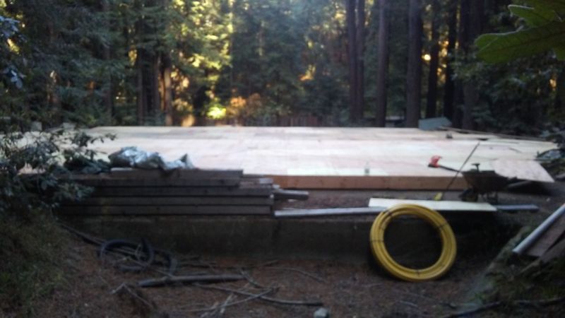

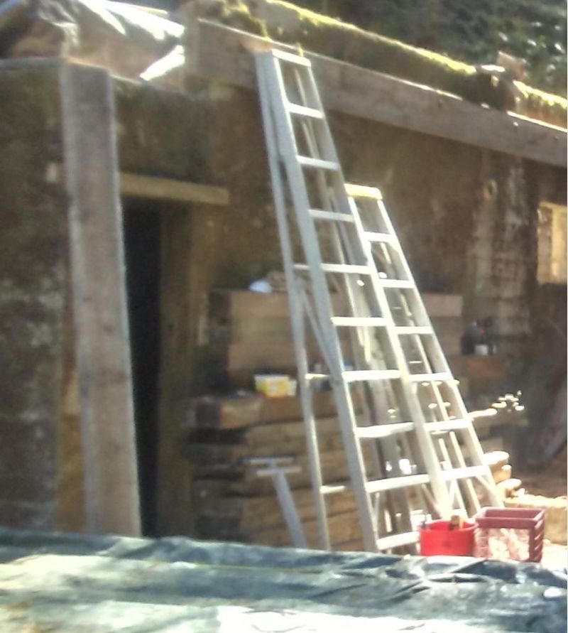

TMT, what it is is more correctly a bomb shelter, per the original plans. My property had a house on it, built in 1960. All that remained when I bought it was the foundation and the shelter. As of a week ago it's now my carport.   IMG_8363.JPG

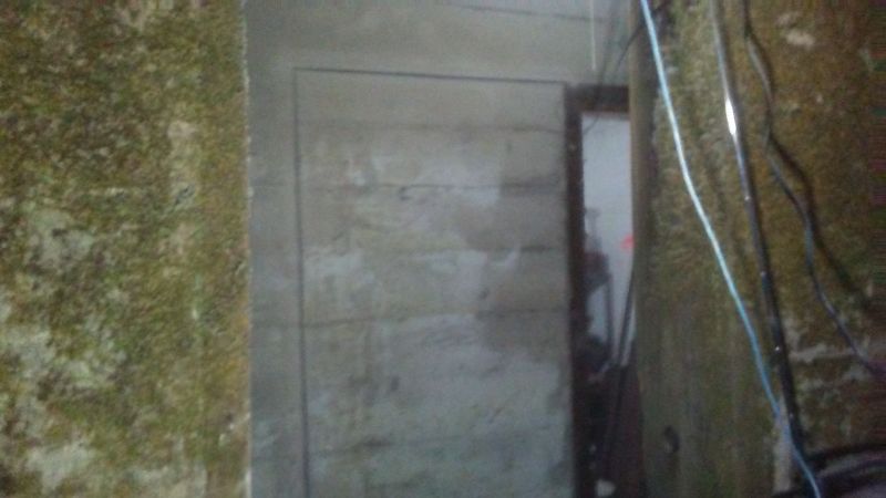

Got started on my door widening project this morning. I bought a cheap $20 7 inch blade at HF and put it on an old lightweight sidewinder saw. Cut much better than I figured, about a half hour to cut one side and still cutting as well at the end as the start. Blade never got hot enough not to touch. The blade is turbocharged, says right on it.
Only 2.5 inch depth though, wall is 8 inches thick. So I might cut the other side, then try some wedges in the cut to crack middle 3 inches. Or get the Stihl 2 stroke with 14 inch blade, since now at least there's a cut to follow. And hopefully the floor was a separate pour (must have been) with maybe some rebar to cut, since I can't saw that.

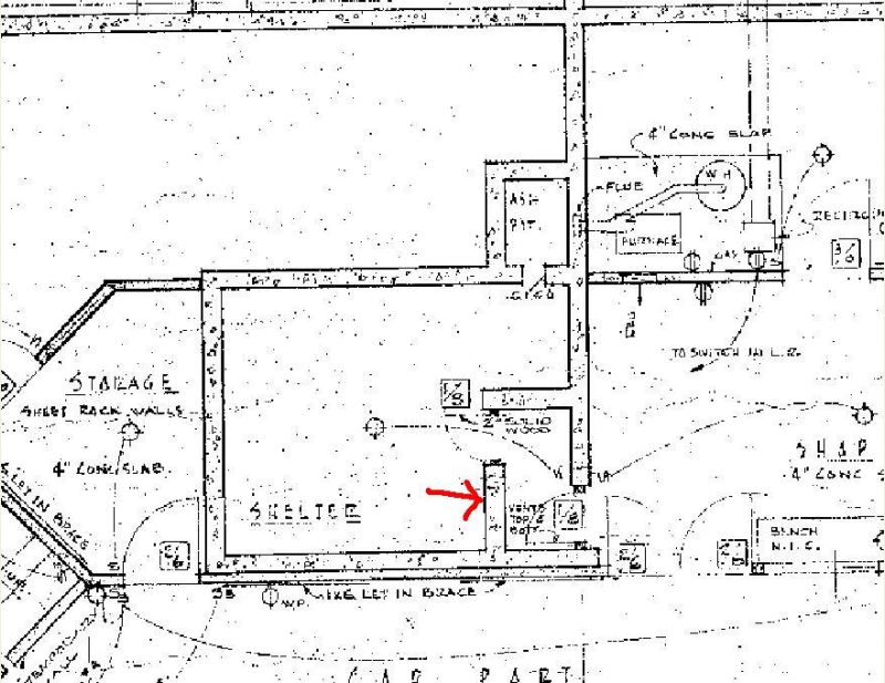

Yeah, it was originally a bomb shelter, built in 1960. 12x12 I think. Here is the original blueprint, and the wall I am taking out. I don't know why it was built like that but i'm using it for a storage room and it's a pain in the butt wiggling things through that little hallway.
When I get it cut on the other side my plan is to take my biggest sledge and work out my frustrations. Also have a 40 lb. electric demo hammer with a chisel bit but that's not likely to do much.

I bought a new 14" diamond blade for the Stihl 2 stroke saw, burned up the old one cutting pavers dry. I want to hook up the water, it has a valve on it with a hose leading to the blade.
How much water does it take? I don't have pressurized water where I'm at. Would gravity feed be enough, or how about a garden sprayer?
