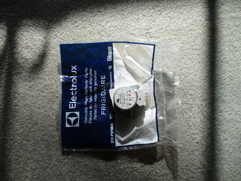

# Posted: 4 Dec 2019 11:41am
After catching the fridge not cooling, for the 3rd time, I went ahead and changed-out the defrost timer. What a difference, back to brand new performance. Now I'm back to a consistent 35F & -30F, better than it's been in a couple of years. 'Just took a couple of minutes, with simple plug-in design. BTW, along with poor cooling performance, my symptoms included excessive noise from the original bad timer.

# Posted: 4 Dec 2019 11:50am
I believe the defrost cycle was stuck on .
drb777
# Posted: 4 Dec 2019 12:02pm
Quoting: Aklogcabin
Yes, intermittently. But I could tap it and it would re-start. Sort of "sticky", a weak/defective tiny little motor.
