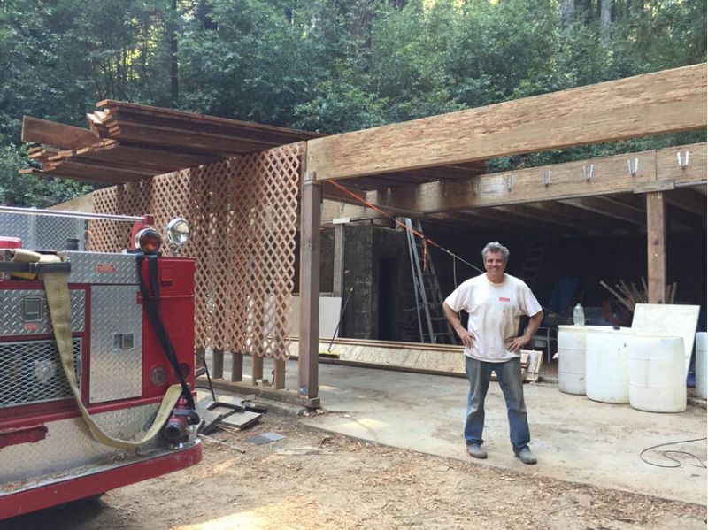

We share a couple things at the moment. We're 'stuck' at the cabin too, our house in the city is under forced power outage due to fires. And my wife has one arm. I normally rest on Sunday but since I'm here might as well get some work in on my never ending carport project. Here's me a few days ago, got those joists in now.
Also have a similar camper van breakdown story while crossing Nevada I'll save for another time. Good luck on the trek.
