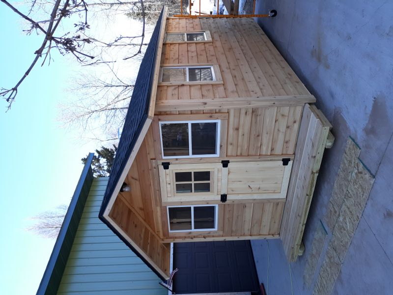

Oh by the way, Ihave stopped using my old web site which was tagged to cabin building. Now it's christensensaunas.com. Sauna

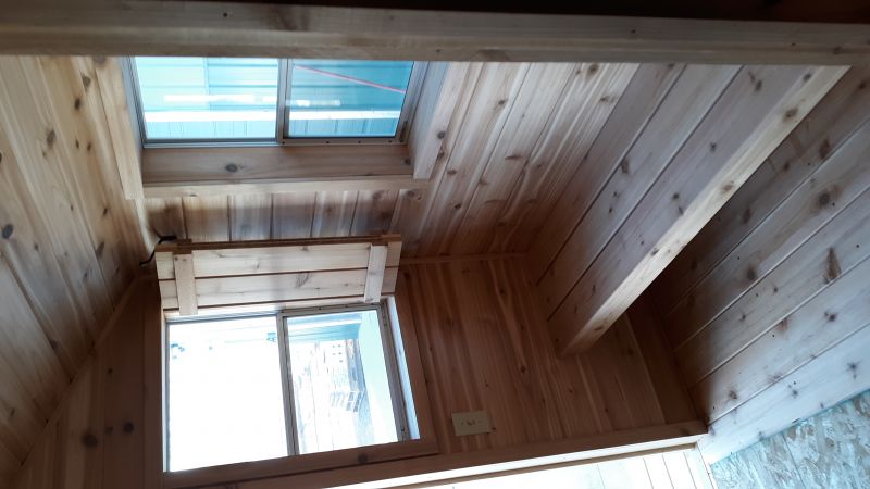

|  Inside sauna

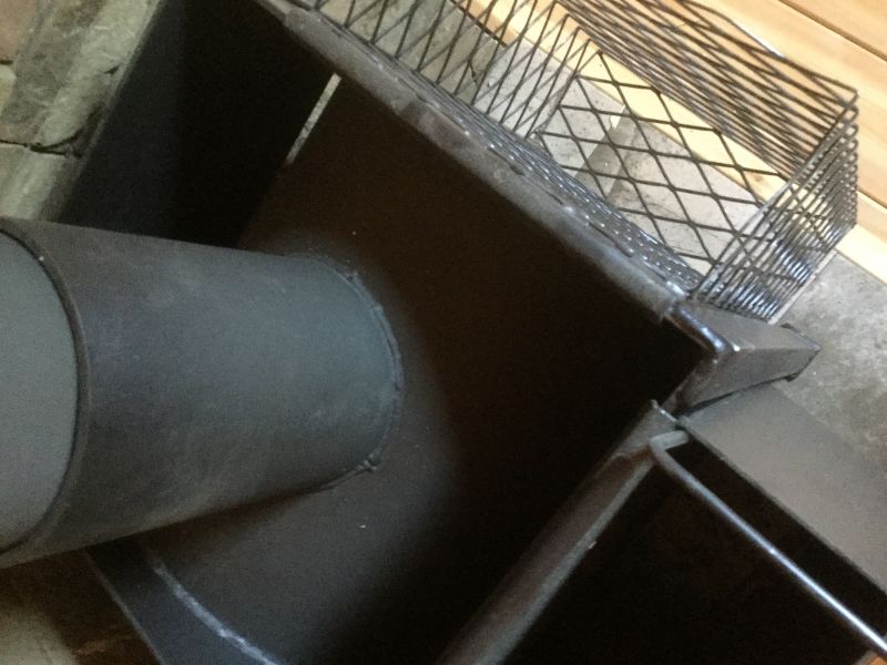

|  Stove for sauna

Great looking saunas. I'm really intrigued by your stoves... they look like a neat design! Your daughters do great work, but looks like they learned from the best.
# Posted: 15 Sep 2019 09:01am

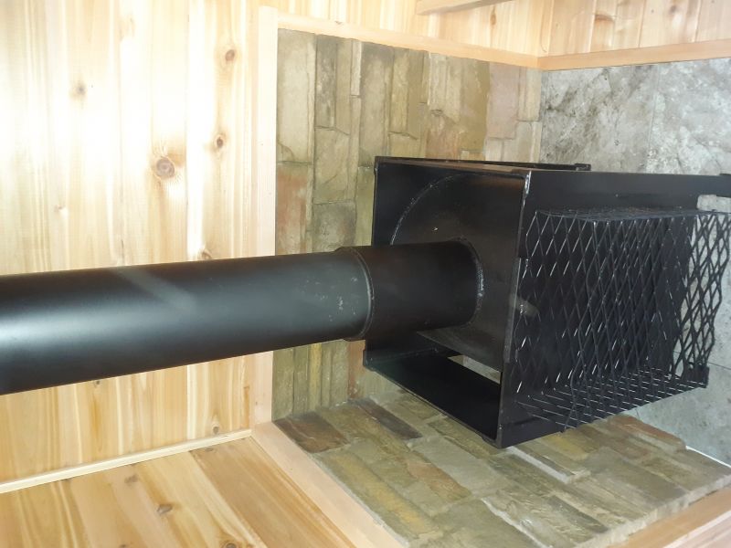

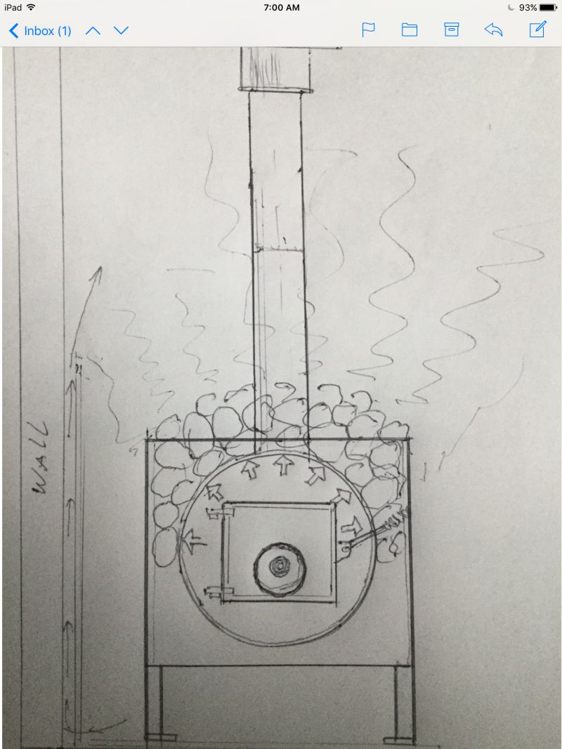

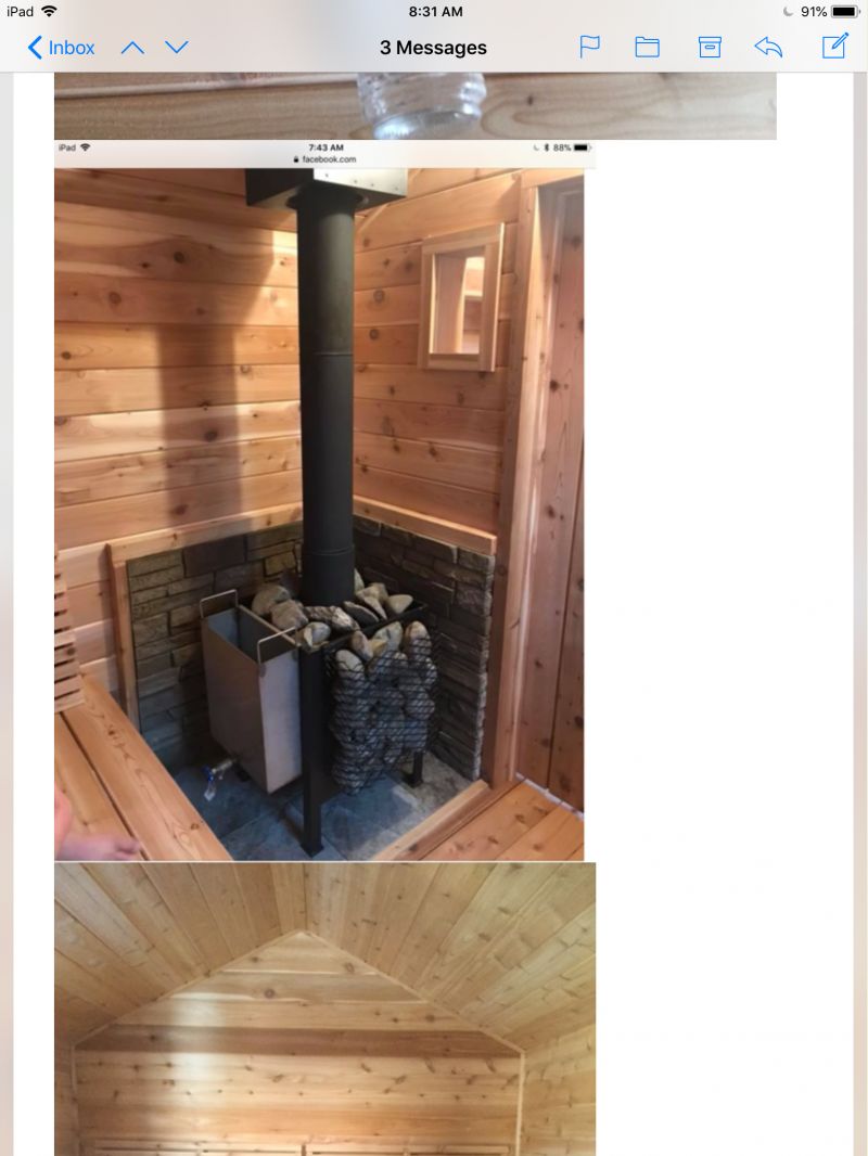

Thanks. The idea for the stove is to use a round firebox, so expansion does not deform the metal, and also allow for more rock mass to contact the hot stove surface. This also reduces heat loss towards the wall to reduce wall temperature. Stove drawing
|  Bare stove
|  Loaded stove

I just bought a small parcel of land near my cabin that has a pond in front of it. My kids want me to put a sauna there. I may in fact put it closer to my cabin so I can use it. Is this a dry sauna model?
fiftyfifty
# Posted: 27 Nov 2019 09:49pm
Owen doesnt visit here as much now that he is so busy with his saunas. But they can be used either wet or dry.The floor is made from tightly spaced cedar boards so the water can drip out (but bugs cant come in.) I have seen them and they are lovely buildings.
