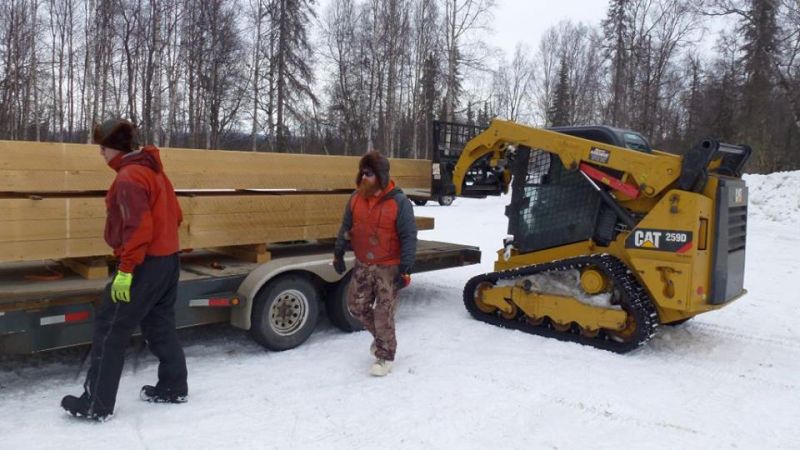

Unloading timbers
Unloading timbers

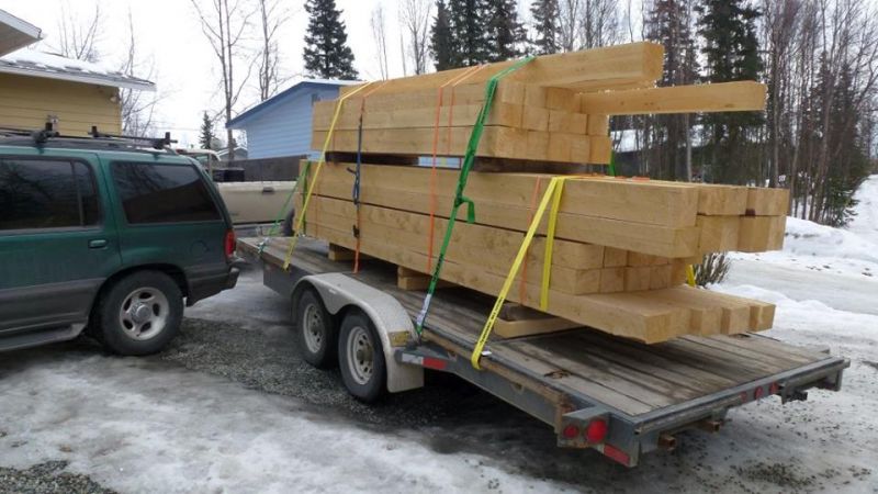

Timbers stacked with a space
