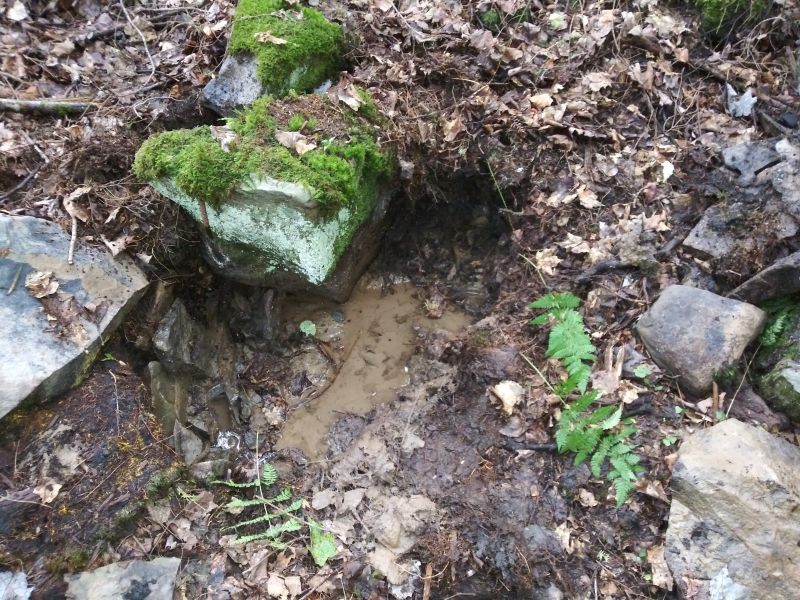

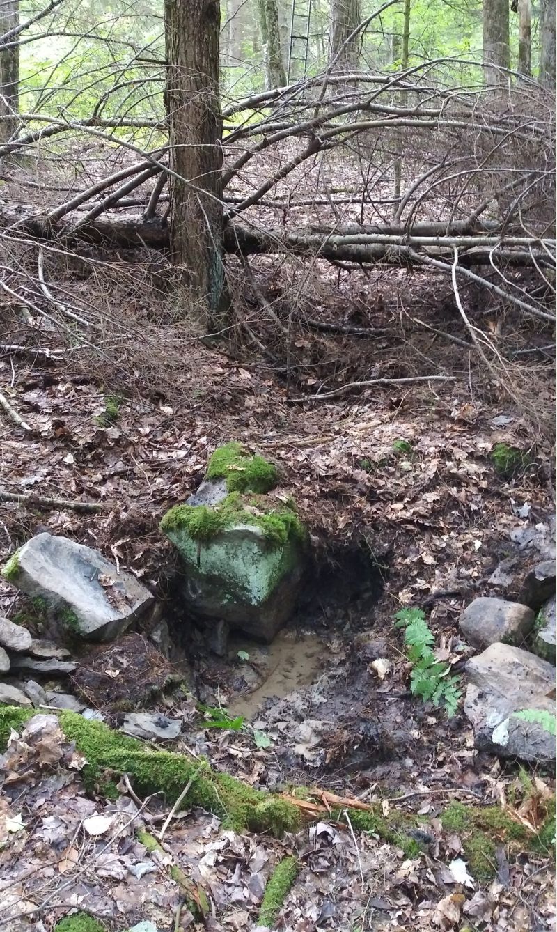

I found a water spring on my property about 200-250 feet from my cabin. The cabin is located uphill from it. The spring comes out of a hill and was hidden under some rocks. I heard some water trickling and started removing rocks and found water right under the rocks. This was just those pass few weeks ago and there was no rain so I know it is not rainwater. I would like to somehow collect the water, I was thinking about driving a shallow well pipe with screen horizontally and then maybe colect the water in a jug or something as I need it. Did anyone here ever done it? I wont drink the water I just wanna use it for washing and shower. Maybe there is a better system for it? The water keeps coming, not a big volume but keeps coming and I checked for a few weeks.
Here are some pictures. I kinda made a small dam from rocks and the water filled the hole about 2 feet deep and 4 feet wide and long in a few hours.

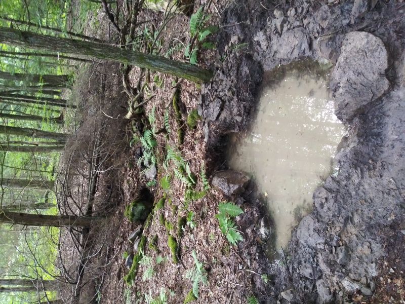

Here is another

I would dig a trench downhill from that point to get a clear flow. How many feet of elevation is above that point? Where it is coming out right now is still through the organic material. Keep digging longer and deeper to find a point where it is flowing well below the organic level. Water on a property is a valuable resource.

Look up “how to develop a seep”. I a doing it right now. Not too hard. Need a shovel, mud boots, gravel, some PVC, and dam (plastic, old barrel, rock and clay, cement, etc) and you create a predicted area and you will be amazed at how clean the water.

You need alot of water for a ram pump. But worth looking into. There are good videos out there on how to make a spring box. Getting clean water out would be my first priority. Moving it to another location would be secondary.
