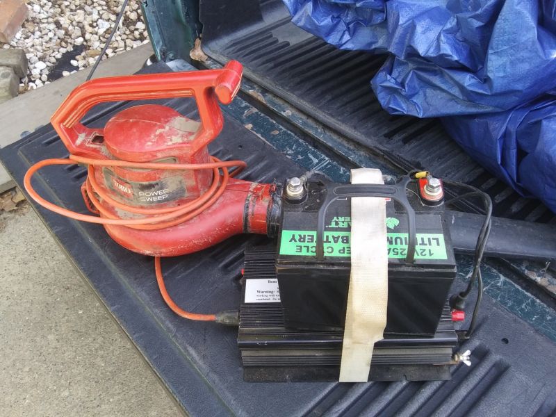

As I mentioned on the Craigslist thread, I recently scored a new in the box 80v Li chainsaw, battery and charger. Only tried it a couple times but it seems powerful enough, though I'll be keeping the Stihl and the Husky.
Anyway I'm waiting for the leaf blower that uses the same battery to go on sale. Dragging a cord from the generator around all the obstacles on the cabin deck is a pain. So I tried a fun little experiment today with my new 25ah Li battery, a 600w inverter and corded blower. Works great! The battery weighs nothing, one finger. The inverter weighs about the same as the blower. A guy could get serious and use a should strap, I just held it in my free hand.
I'm still going to buy the 80v blower but this makes a nice backup.

Well I had a little problem with my portable battery/inverter/blower. I was clearing off the cabin deck yesterday, going pretty well until I shut it off to move some chairs, after maybe 10 minutes of run time. Turned it back on, it struggled for 2-3 seconds and I shut it off, figuring the battery was now too low. Brought it back to the grid and plugged in the blower. Dead.
This is the second AC tool that has died on me recently while plugged into modified sine inverters. About a week ago I was using a cheap HF angle grinder, leaning on it pretty good, got a bit warm to hold, and then died. Plugged into a different MSW inverter, the one that has powered many other power tools. It did not have removable brushes, I opened it up and it sprung apart, tossed it.
Both of these were not variable speed motors, should be fine on msw inverters but I think it's time to look at a pure sine inverter.
# Posted: 22 Jan 2021 03:21pm
Some MSW inverters produce AC power with fewer steps, some have more. The difference can be seen with an oscilloscope, but most folks don't have one of those. More steps are better. So no way to know what your MSW inverter is supplying. Price can be a guide but may not always be a reliable indicator.
Those square steps are tolerated better by some motors. That too is not too easy to find out. Crapshoot in my experience.
Even the motors that can tolerate MSW better will run hotter than they do when used on Pure Sine Wave power. That is just the nature of electricity and motors. They run hotter because they actually consume more power, more watts when run on MSW instead of PSW. Motors produce heat at the best of times when run on grid power. When you are loading the motor load heavily the motor makes extra heat. It is relatively easy to work a cheap HF tool hard enough to make it burn out on grid power. Using MSW power makes that worse; almost a guaranteed failure if worked hard and long.
If a tool motor is using more power because of MSW the extra energy must go someplace. It is turned into heat. A 20% increase in watts used creates 44% more heat. A 50% increase in power consumption creates 4 times as much heat. That is just the way electrical power works.
Variable speed controls and other electronics can die quickly; as soon as turned on once depending on how the tool manufacturer has designed the tool. Constant speed motors just take longer to kill on MSW; the extra heat is the real killer. Some motors are not built robust enough to take much extra heat.
MSW power has a lower voltage peak than PSW power. That alone can cause some motors to not start as easily and be damaged.
# Posted: 22 Jan 2021 07:49pm
My simple comparison test thus far has been to run my tool of question on grid then on the msw inv then on the psw inv. It has been obvious which inv. is closest to grid powered; thus the one to use.
So far nothing has failed on me.
# Posted: 26 Jan 2021 11:50am
Since that little blower that stopped working was easy to take apart for the switch, I took it apart again to see why it stopped while on the inverter. The commutator was black, I gave it a quick cleaning and off it went again.
Maybe the MSW causes the brushes to burn? Don't know. I'll try it again, it's just a spare thing, don't care if it burns up completely.
