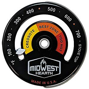

I am not sure of the name, but I did buy a granular stuff, supposed to keep creosote clear. I put it in a small lunch bag, not much, tablespoon or so and toss it into fire. I got it from Amazon. I think it was one you mentioned.
I also have this exact megnetic meter, stuck on stop pipe (single wall section) about 12" above woodstove and keep the gauge in the sweet spot.
It was Rutland Creosote Remover.
