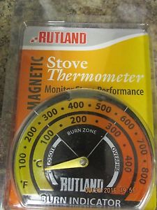

# Posted: 16 Feb 2019 09:26pm
You should have one of these for your stove pipe.
