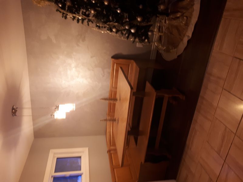

I didnt build it but I have a corner unit with bench and table and it can stand freely. I can take pics and measurements so you can copy it

Heres a pic of the corner table. It has hinges with storage but there is no reason why yours cant go to the floor for full storage. Let me know exactly what measurements you would like.

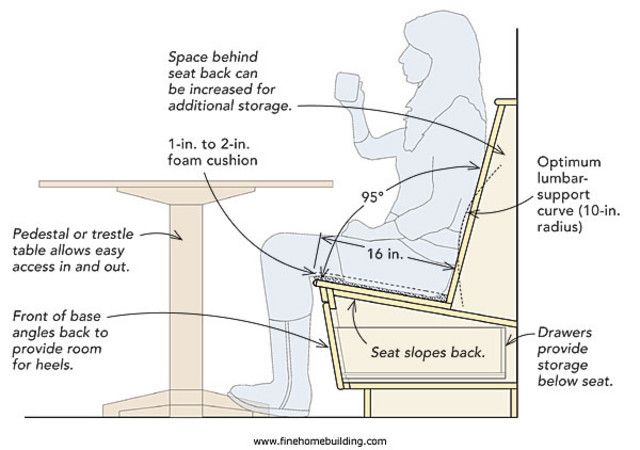

One consideration for bench seating is that the seat should not be level, it should slope downwards by 5 degrees towards the seat back. Likewise, the seatback should not be perfectly vertical but angle back by 5 degrees as well. The seat surface should extend about 3 inches past the front of the bench so that the user's legs don't press against the frame.
This article shows some of the proportions necessary for comfortable seating.
https://www.woodmagazine.com/must-have-measurements-for-comfortable-seating
This drawing shows dimensions for a built-in banquet booth seat, but the same proportions and angles are applicable for a movable seat bench.
