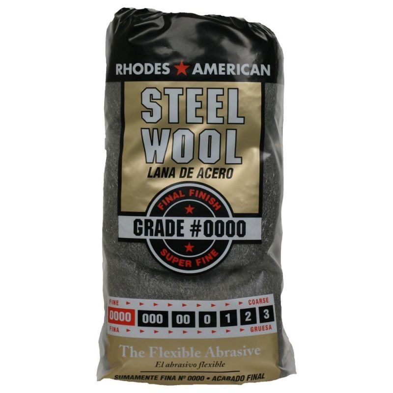

Than I went throughout the entire interior of the cabin on a very sunny day and found so many small gaps where the mice had been getting in through the log walls.

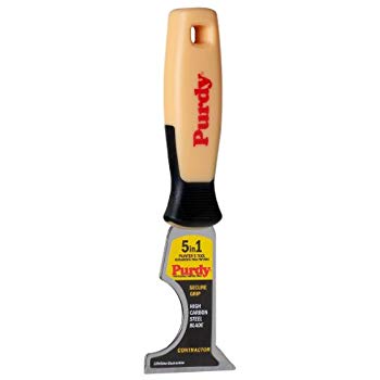

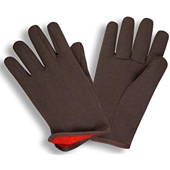

Some gaps were there due to shrinking/settling of the logs, other gaps were small holes that the mice chewed (not many of those thank goodness). I used the pictured steel wool, 5 in 1 tool to stuff the holes with the steel wool, gloves to pull apart the correct amount of steel wool needed and a small bucket to catch errant fibers.

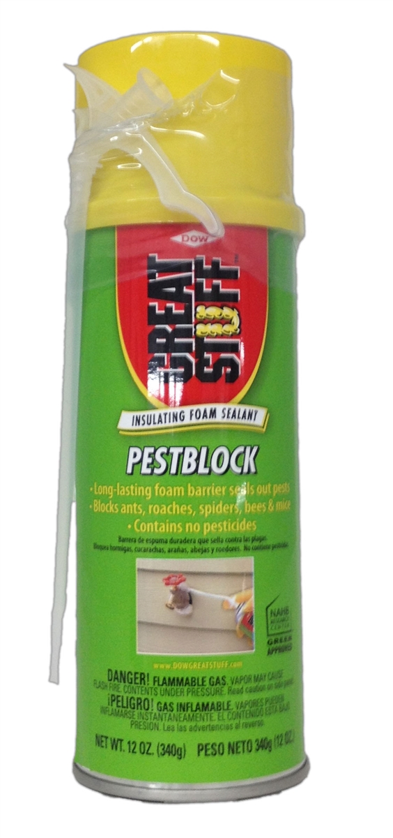

The largest gap I found was under the kitchen sink. It was to big to fill with steel wool. I filled that with the spray foam pictured.
Before we had spray foam in the floor every summer at night we would light up the cabin and crawl under the cabin and fill holes in the sub floor with the spray foam pictured. Not many but just enough for a mouse to get through.
