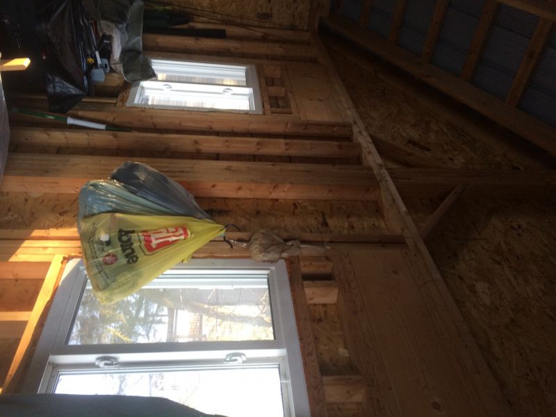

I checked the construction of the addition. Hmpf. Rafters are 2x10, ridge board is 2x2x10. Walls are 2x4. It is nailed into the main cottage but through the siding. The perlins I think we're 2x4, possible 2x6. The rafters abutt the main cottage but don't seem to be tied in. I will need to add collar ties and ceiling joists at minimum. I guess I should have someone take a look before doing much with that room. It is currently for storage like a garage but I would like to make a bedroom or sitting room.
