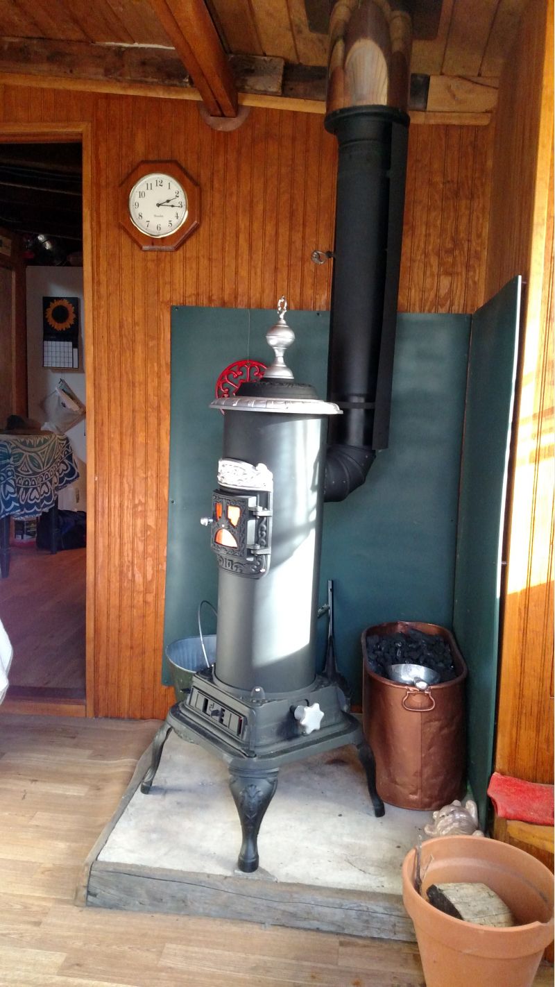

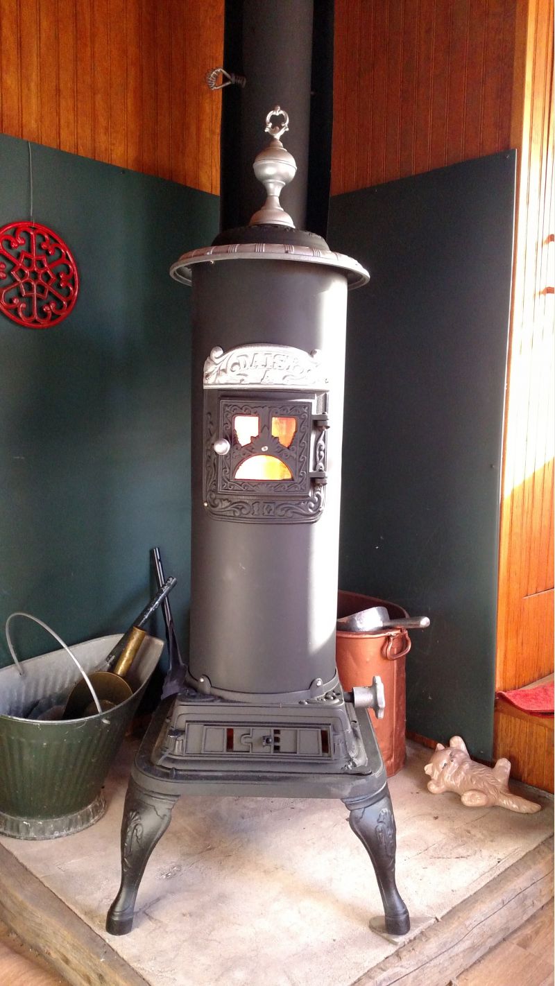

One option if your local codes allow it is an antique coal stove. Some of them are quite small and the beauty of coal is that it burns all night long. Or you can make a small wood fire in them just to take off the morning chill. Depending on condition they can be quite inexpensive, too.
I found this stove disassembled and all rusty under my old cabin. I cleaned it up and used it, then when I moved to a new cabin the people taking over my old place didn't want it, so I took it with me. Last year I restored it properly and installed it in our bedroom, it's the perfect size (there is a larger wood stove in the living room).
The cool thing about it is that it was made about 100 years ago in a town only about 15 miles from my cabin.

Thats pretty cool Fanman. I like the wood faced concrete under it. How many sq ft does that take up in the corner of your room?
Fanman
# Posted: 9 May 2018 09:09pm
I don't recall exactly, about 3' square or a little less, to maintain the required 18" wall clearance with the metal shielding on the walls. For sake of scale the body tube is 10" diameter. Probably don't even need the concrete, there's no heat on the floor, those stoves used to be installed even on carpeted floors... but it adds safety if a burning chunk falls out.
The concrete also serves to support the wood floor, I poured it over the rock under the floor as I was building the addition. One neat thing you can't see in the photos, I poured the concrete and left it for the night. The next morning I found a set of squirrel footprints running across it, preserved forever in the now dry concrete.
