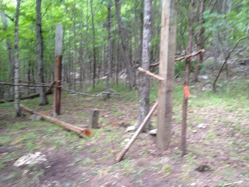

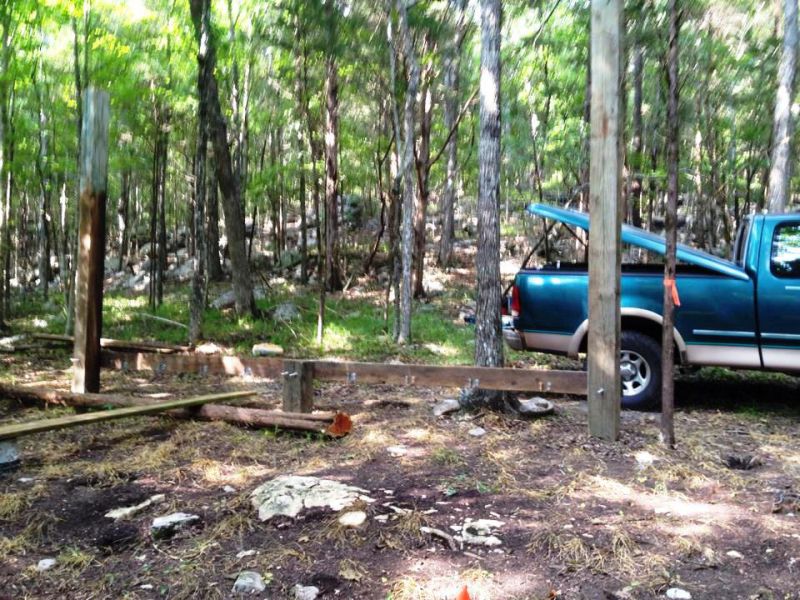

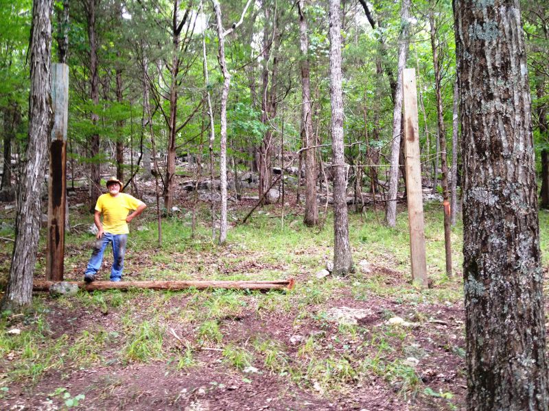

# Posted: 8 Jun 2016 10:09pm
some pictures of me doing exactly what I describe above using 8x8x14footers .

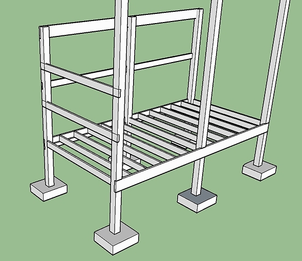

A good rule of thumb is not to set support posts more than 8' apart. A 4x4 will probably check out as long as the unsupported post height stays short, unless this is high snow or wind, or unless you invite your whole class over for a party.
Notice you are asking for exception due to budget, useful life, what car you drive... etc. Physics doesn't work that way. Gravity works the same for rich or poor. If the fair wind blows your poor shed into your rich neighbors Oldsmobile you'll find the laws of man do not work the same for rich and poor.
My guess is that you haven't budgeted yet and don't have enough to build this. Before you touch a shovel or hammer, draw a plan, stick by stick, we can help. Sketchup is a good free drawing program that is easy to use and useful for later when you build your house. With that plan you can make a materials list. With that entire list of everything you will need, you can go wander the aisles at the building supply and get prices. Then see if this is still a go or if it will simply suck you dry and not get finished. As a builder this is probably tougher than building, determining if the person can build and how much... you don't want to get stuck halfway and lose everything you put into it... make sense?

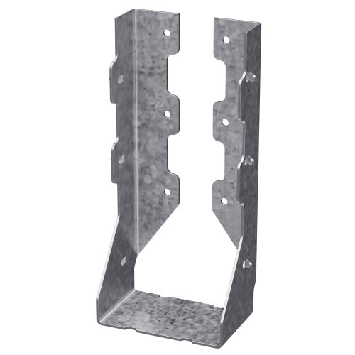

I was thinking something like a Simpson HUCQ. The design process there is first determine loads and decide how you are going to support them. In a post frame for instance the roof can be supported on a beam just under the rafters that runs from post to post (I would lean towards doing this) or the rafters can be supported on studs which bear on the floor support beams.
Assume an 8x16 building with 6 posts, the roof for this example is bearing on a beam above so I'm omitting its load for now. The floor joists span ~8' (2x6's at their limit). The joists bear on ~8' long girders that span from post to post and rest in the concealed flange hangers. Need to find the size of the girder and hanger...
Half of the load on each joist rests on one girder at it's near end, half of the joist load rests on the girder at its far end. The tributary load on the girder then is 4' of joist span X 8' of girder span... 32 square feet. design load typically 40 lbs per square foot live load + 10 psf dead load (structure weight)... 50psf x 32sf= ~1600 lbs ... half the girder load is borne by the hanger at one end, half rests in the hanger on the other post. Hanger design load 1600lbs/2 = 800 lbs The hanger needs to be rated for at least this for a floor bearing only setup.
Girder size...
1600lbs on an 8' span
http://www.timbertoolbox.com/Calcs/beamcalc.htm
I won't bore you through that but a single 2x10 or double 2x8 of good material is up to that load. There is a double 2x8 concealed flange hanger HUSC28-2, looks to be good for about 1500 lbs, we need 800, check.
