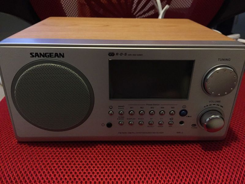

I'm sold on the Sangean WR-2, 'have several, many say they are comparable in sound to Bose. Not cheap, but great sound, has external antenna connection, 12vdc capable and works well as amp/speaker for computer, Ipod (mp3) or smart phone.

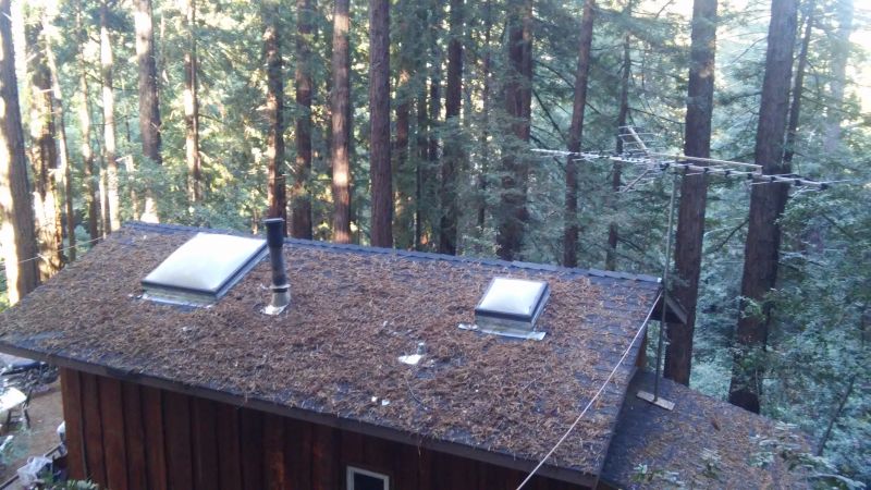

# Posted: 17 Feb 2018 09:33am
Thanks again SE. Well, looks like I'm ditching the Sangean. When my VW diesel Rabbit pickup finally blew up a couple years ago I sold it to a youngster who planned to make a hot rod out of it and let me keep the Sony CD radio it had in it (he sent me a photo of it later, super duper TDI engine, new paint, all fixed up, glad it went to a good home, loved that little piece of crap).
Anyway, I took that radio out to the cabin yesterday and connected it to the roof antenna. Wow, great FM reception, no wandering, no interference from other cabin electronics. So looks like that's the plan. Plus it will play a CD if I ever get one. I still need to tee the antenna back to my 12V TV for the one station that gets, hopefully that won't change anything.
Here's my antenna, almost as long as the cabin!
