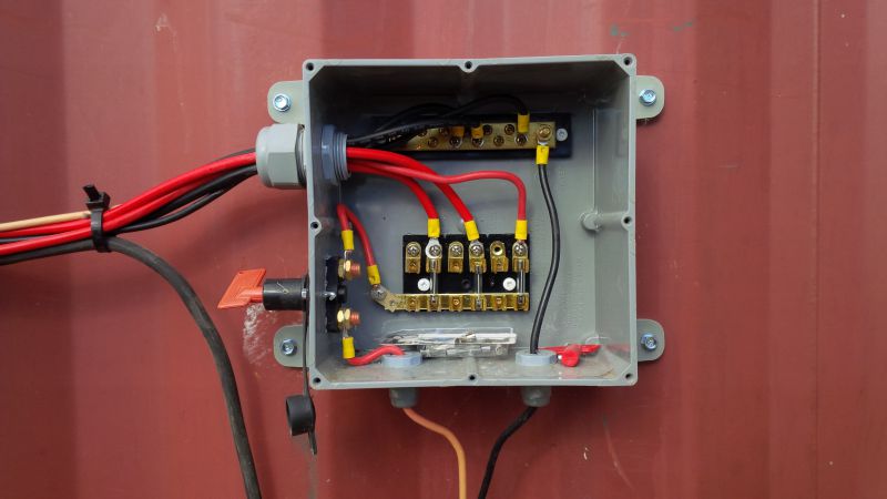

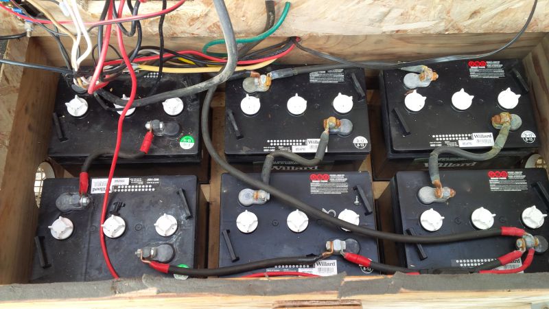

Quoting: beachman
Haltzy - noticed two plugs running off the 1000w inverter. I assume these go to a distribution box with circuit breakers? How did you tie these in?
The two plugs coming off the inverter are just short extensions to a weatherproof receptacle on the outside of the box. I rely on the breakers in the inverter for the protection.
Here are a couple more pics.
Cheers.

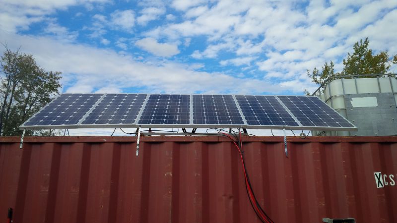

Pannels
Pannels
Homemade Combiner Box
Batteries
Batteries

Haltzy -thanks for the info. My battery bank is much smaller but should be adequate (I hope).

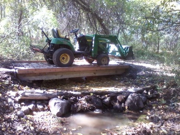

This was a great year for me.I got the horse barn finished up.The back (junk room)room done.New water tank set up inside.The guest cabin is under way.bridge built over the creek.more gravel put in on the driveway.Dozen's of smaller projects completed.Yes a very good year.

Rayy - Do you have pics of your bridge? Im looking at building two of them. One will be for walking only and one will be for ATV's.
Thanks.
# Posted: 18 Jan 2016 05:06pm
sure here is my bridge.

Very Nice... are the beams and decking 3x12's? Did you put in 2 or 3 beams?
What is the weight of your tractor?

Welllll,,,the two runners underneath are 2x10,s treated.The deck is 2x6 treated butted right together and the gun walls are 2x4 treated.The span is 12 feet and there are two support struts under it at the half way point to support the middle.The tractor with bucket ,,,,2000 lbs.It's tethered with a chain tied to a tree incase the flood stage floats it up and out of place it wont go to far.

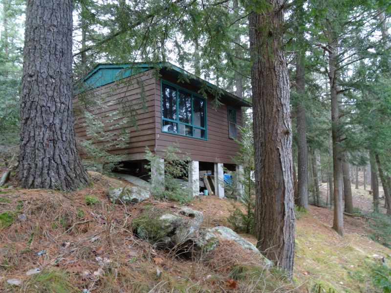

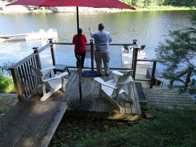

The main thing that I accomplished this year was to enter the ranks of "small cabin owner" and to join this forum. I've wanted a cabin getaway for years. However I'm very frugal and never thought that I would actually pull the trigger on a purchase. My father-in-law passed away recently (my mother-in-law in the not too distant past also) and left my wife and I bit of inheritance. He, like me, always wanted a wilderness getaway. He didn't give me much advice over the years, but he did tell me towards the end that if I wanted to do it I best not wait. I've owned the cabin for almost 5 months now. I'm over the buyers remorse period and I'm excited but a bit intimidated by all of the work and learning that I have to do. I've attached a couple of pics of my 360 square foot beauty. Each time I go up I love it more. It's about a 4 hour drive, but there was nowhere closer to get what I wanted. On the edge of Muskoka in Ontario on a beautiful river.
Cottage
Cottage
Dock
Dock

Absolutely beautiful KelVarnsen

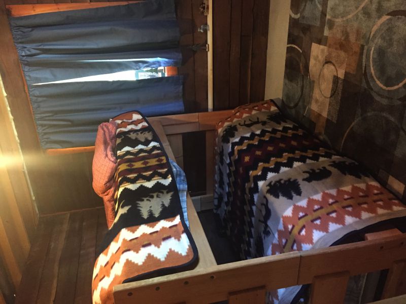

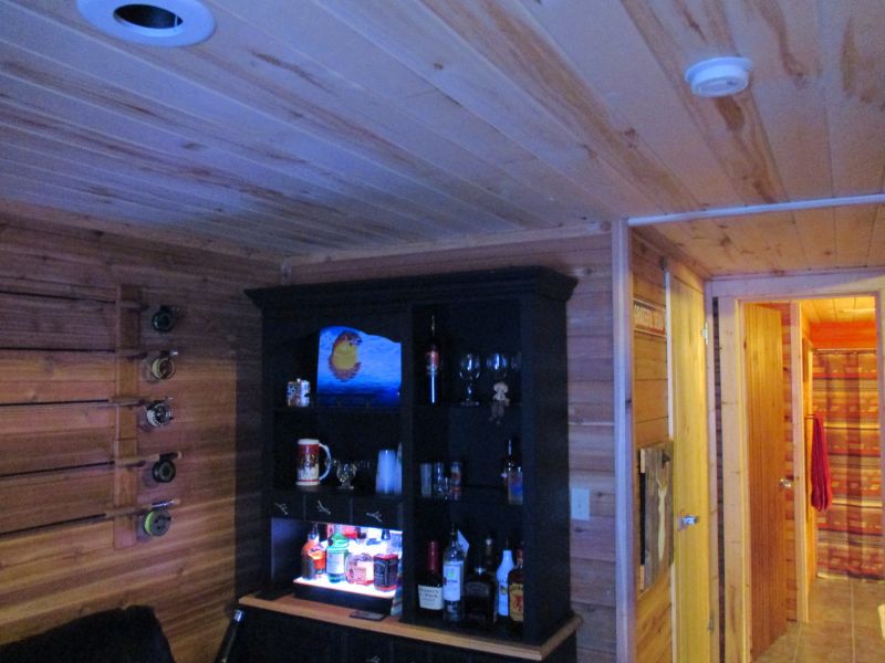

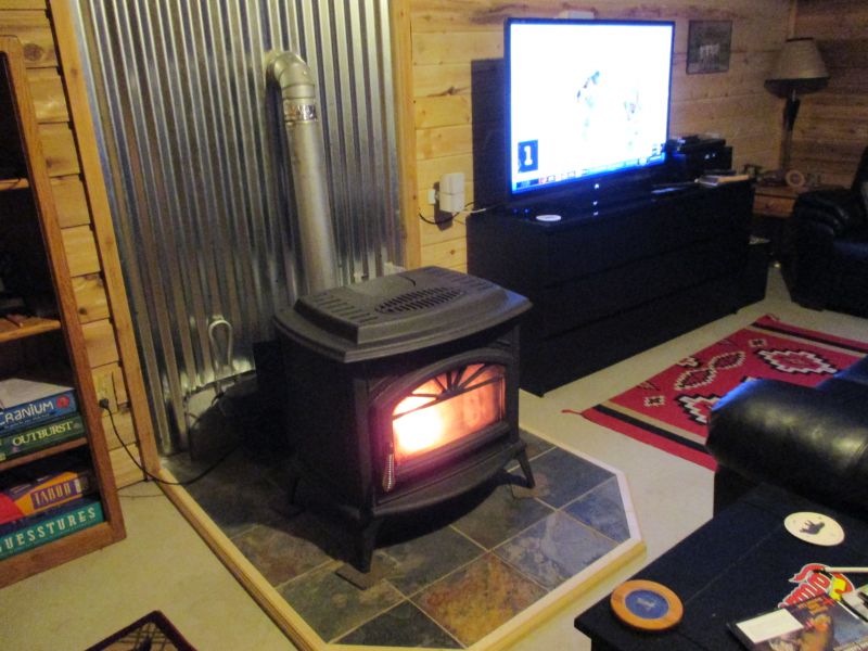

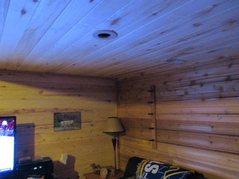

Finished lower level(additional bedroom with bunks,full bath and comfortable living area)
changed it from cabin to home
