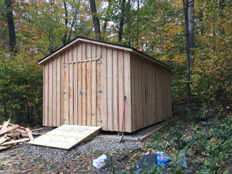

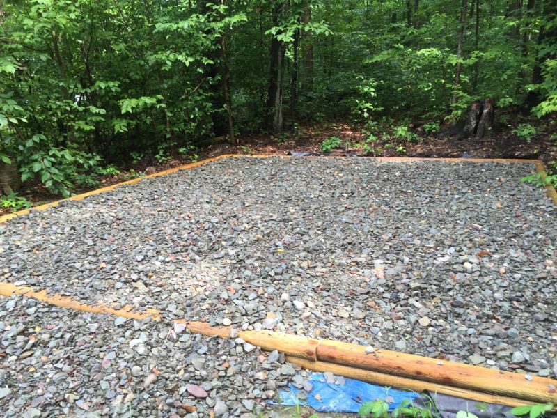

I also have a cabin in upstate by Swain, NY. My shed is pretty close to what your a doing except it's has a floor and sits on three 8" x 8" pressure treated timbers. I first laid down geotec fabric as a vapor barrier. I built up the sidewalls of the gravel base with landscape timbers and then filled it with compacted gravel. I've been happy with the results.
The main problem was the dump truck of gravel I needed would go down a short but steep hill near my cabin so I had to shovel and trailer it back a load at a time.
