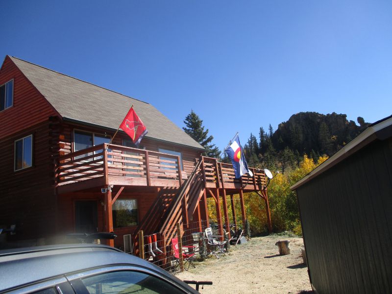

We have cabin up in Park County Colorado(9600FT elevation) We were up there last weekend. Had a little snow.Temps were in 40-50 during day and 20's night.We get up a lot during summer but maybe once a month during winter.We never totally shut it down.Leave on (52) I did(turn well off) and drain most water out of lines and toilets (didn't blow it out) added anti freeze I guess I'm wondering when and what others do as winter? I guess no such thing as over prep but........I won't be back up until after Thanksgiving temps could be colder by then and then not until right after Xmas (for sure cold then) anyway looking for winterizing rules of thumb

That aint no cabin, thats a house

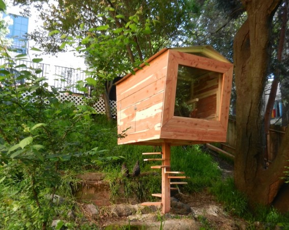

OutdoorFanatic
# Posted: 5 Nov 2015 09:27pm - Edited by: OutdoorFanatic
this is a Cabin

With the exception of the Cardinals flag you have a nice cabin mick.

It sounds like you are fairly prepared the only thing I would add for you is an alarm in the event your heating system fails. From the photo it looks like you are on the grid with internet access so an alarm should be a simple install.

thanks on all the responses (we are from St.louis so wife likes to wave her Cardinal freak flag high) me-I could give a sh#%! anyway -I forgot to leave the drain valve open(tank) (I knew there was something) with heat on (52 ish) I did turn hot water heater down (vacation) hopefully be OK....checked extended forecast out there next couple of weeks (30's and teens) I am back out Thanksgiving I'll do a more thorough when I leave after that I don't know when the bears go to sleep out there (had one last month up on deck having fun with our gas grill) good stuff
